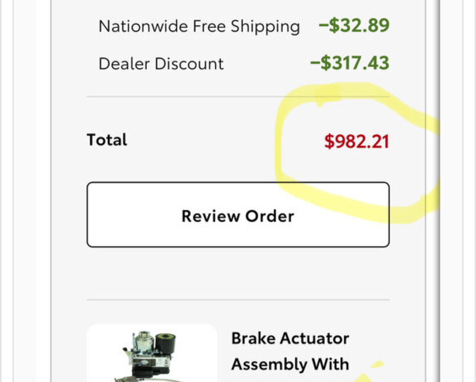

    It is called a "Brake Actuator" by Toyota and sometimes simply "Master Cylinder".
    I am sure he has heard of that.
    The part price a week ago shipped was $982. Somebody who works on Toyota and has their Techstream scanner could do it in four hours. You do the math.

    I don't believe the brake actuator and master cylinder are the same thing.

    You could DIY it with an ebay (used part: $250) for...if you wanna have...fun...and get brake fluid everywhere :)

    Oh no...I am equipped in no way, shape, or form to do my own brake job. I'm taking it in this week to have it done.
