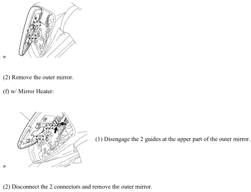

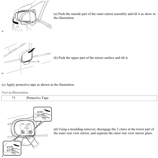

    Edit: looked in the gen 3 manual, they suggest a wider "molding remover" tool at the bottom edge, essentially the same as a yank. After putting some protective tape on the lower lip of the housing where the tool would bear against it.
    Once you have it popped out, if it's heated, you find a couple little electrical connectors to unhook. and if it isn't, you don't.

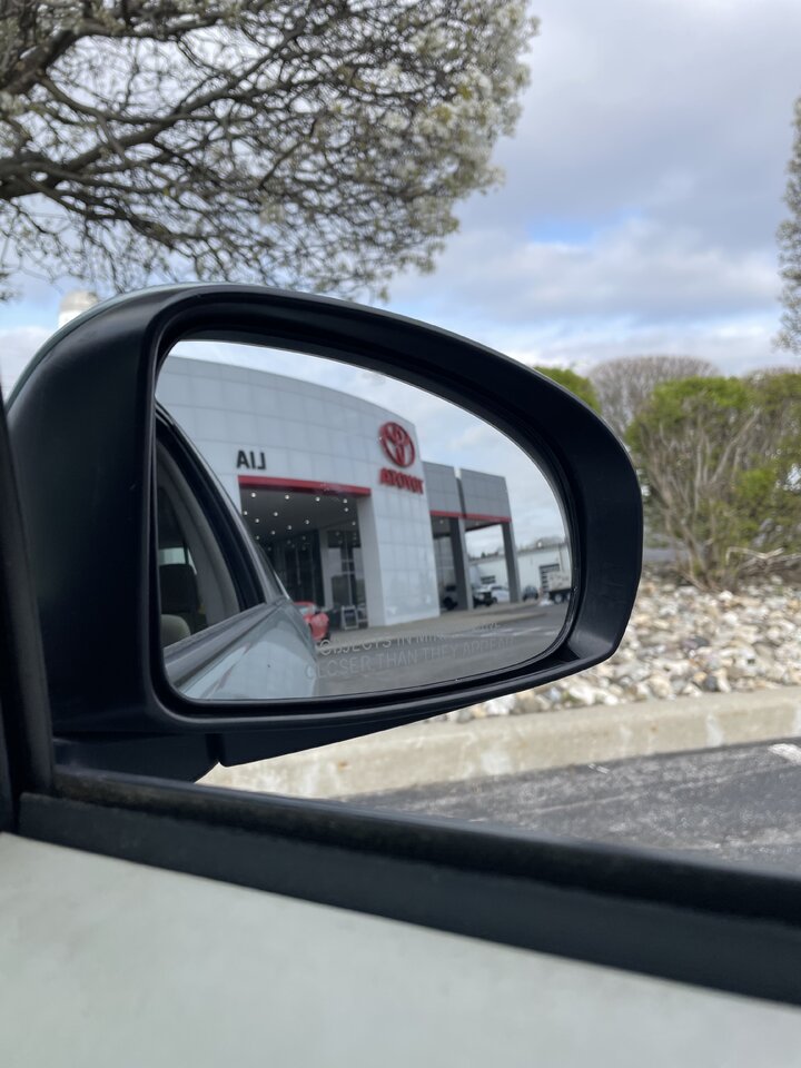

    Mirror replaced. It was the heated one. Successful project! Thanks PriusChat!
