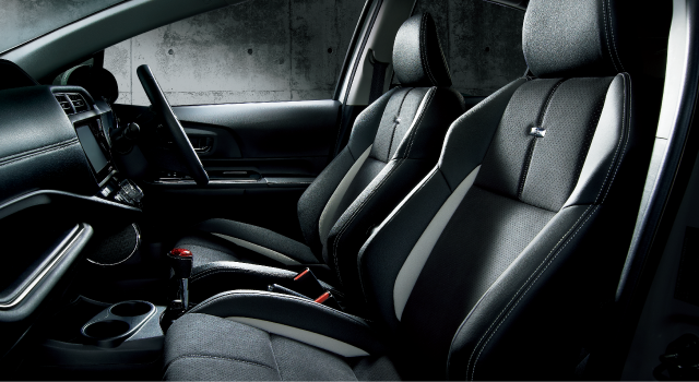

    I'm actually VERY interested in getting aqua G's edition seats. VERY sporty looking! [​IMG]
