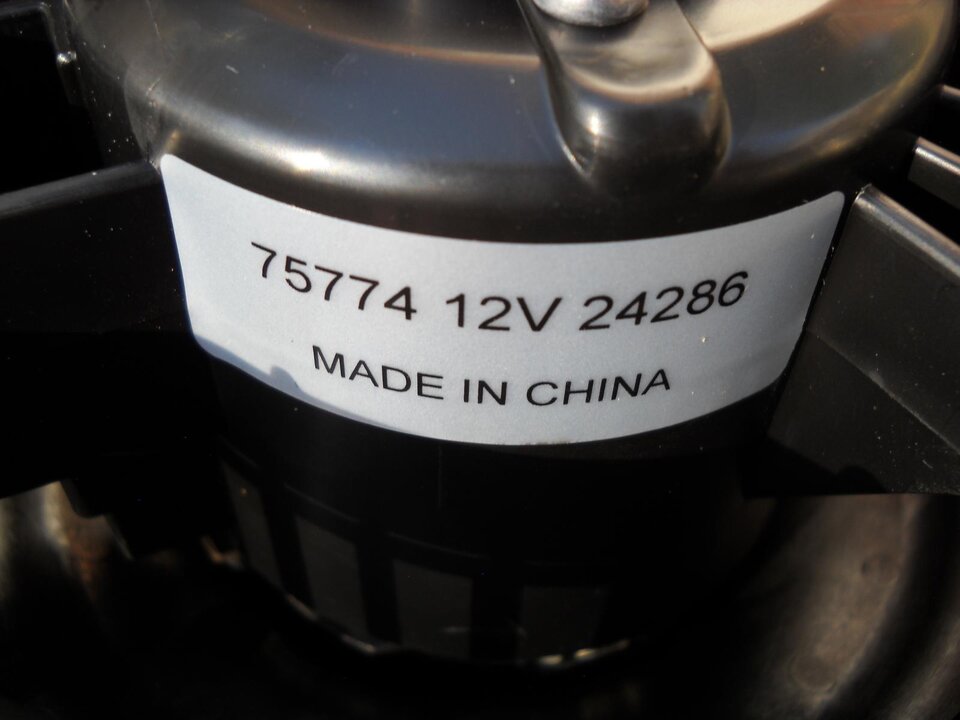

    I bought the Continental one from AutoZone and it arrived with a "generic" sticker, made in China. It also had a black plastic blower wheel, without the clamp - the wheel had a different design. I used their "ship to home for 20% discount" offer, so at least I didn't pay *that much* over the RockAuto price.
    Interestingly, the part number on the motor itself on mine was 75774. It also had what might be a date code of 24286 on it - October 12, 2024. The date code cast into the plastic was definitely October and maybe 2018 (the arrow was between 18 and 19).

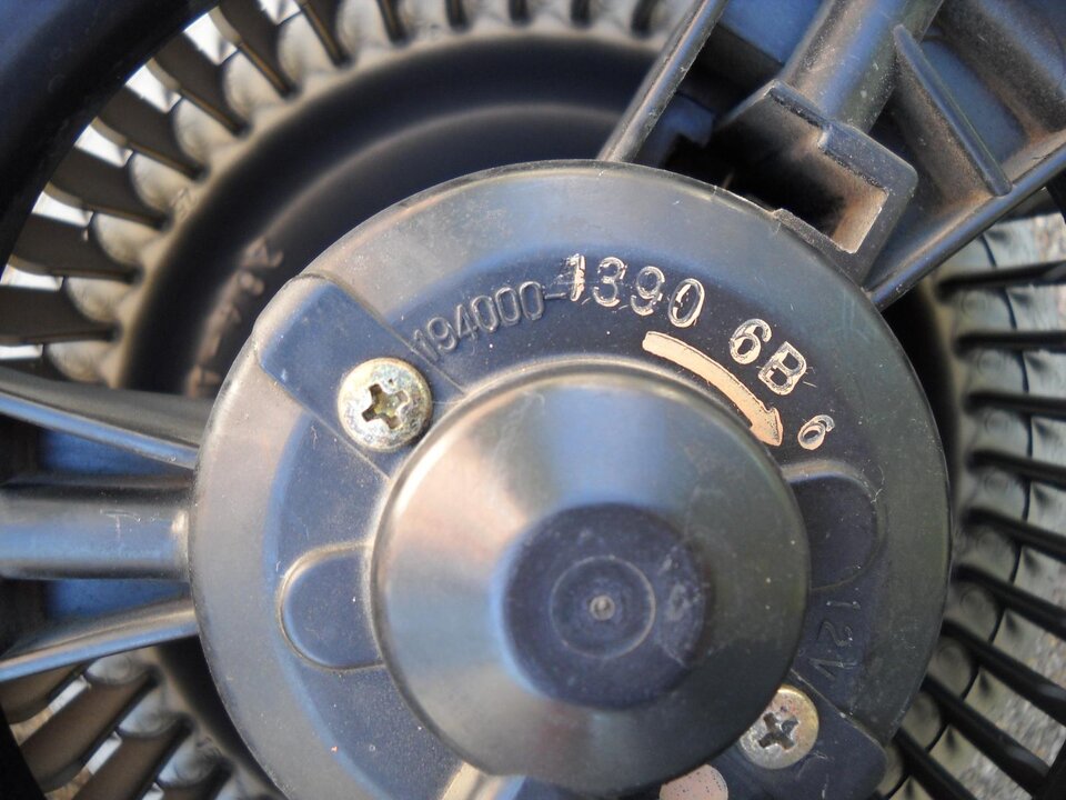

    The Denso part number on the old one is apparently 194000-1390 6B 6. The "6B 6" might be a date code, lot code, etc.

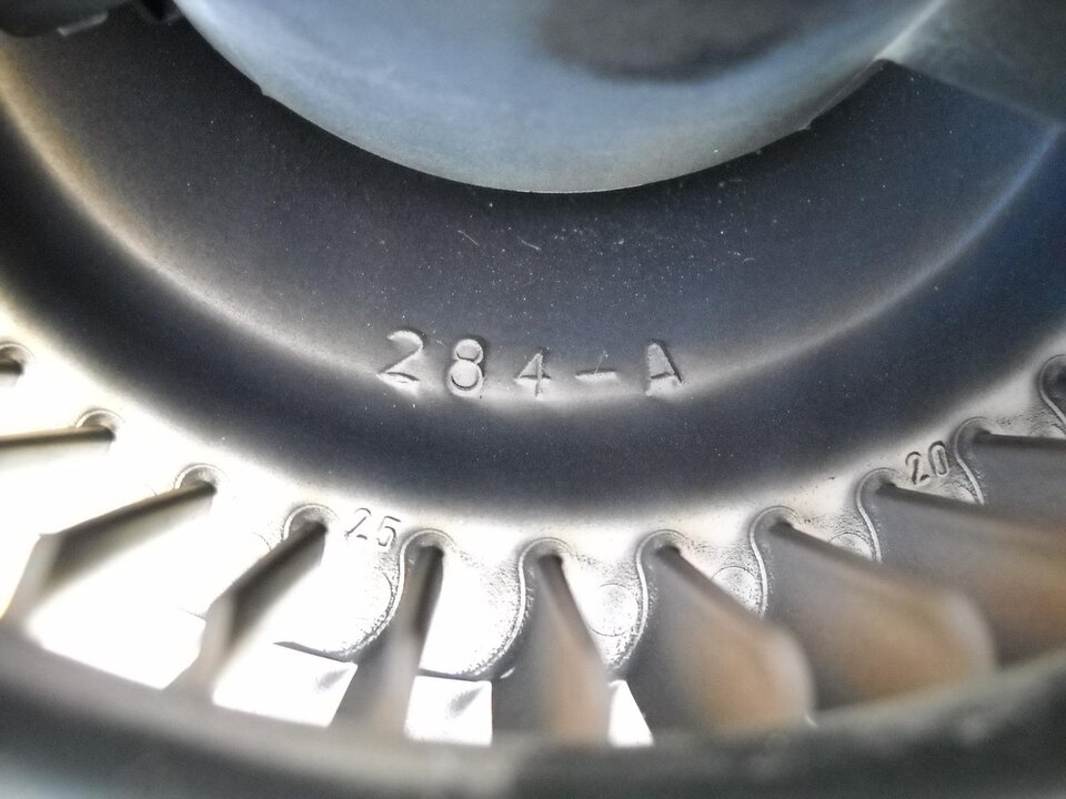

    Denso also numbers the vanes on the blower wheel, every 5 vanes. Yes, really. :)

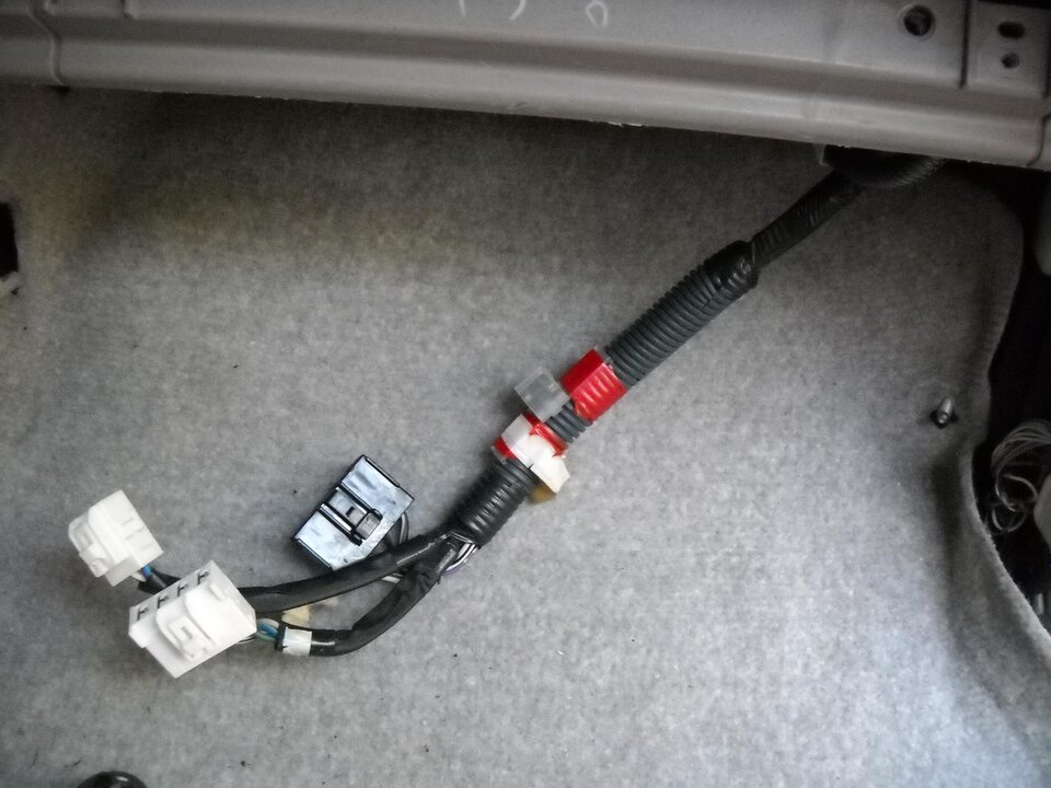

    Under the blower box, unplug 3 electrical connectors on the inboard side. One is black and two are white; the black one is for the blower motor controller, and the white ones are for the PTC (electric) heaters that are in the heater core and (optionally) in the heater outlets. They're all different, so you can't mix them up.
    Follow the harness back from those 3 connectors to a clip in the center front (FRONT) of the blower box. Access to the two front (FRONT) screws is a lot easier if you can undo this clip. It isn't a peg in a hole; it's just a U-shaped clip, with fins inside the U, that pushes down over a tab sticking down from the blower box. I pulled the wiring harness forward, and the back of the clip back, and got it to release.

    The part number on the old blower motor, and a detail showing how the vanes are numbered.

    The part number sticker on the new blower motor.
    The harness you unplug, and mechanically unclip, to get more room.

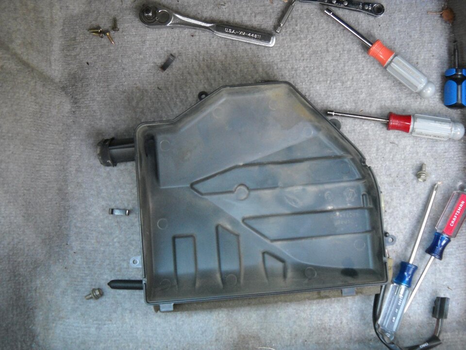

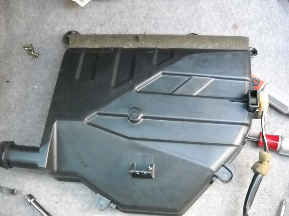

    The bottom of the blower box, sitting the same way it is when it's assembled. You can see the four screw locations around the outside edge, and the "snout" that plugs into the HVAC ducting at the front (FRONT) left.
    The bottom of the blower box, flipped over. This is what you'd see looking up at it when installed. The tab sticking up at the center bottom is what the wiring harness above clips to. The edge with the foam tape is normally right in front (FRONT) of the glove box, and the edge with the tab and the snout is towards the firewall.
