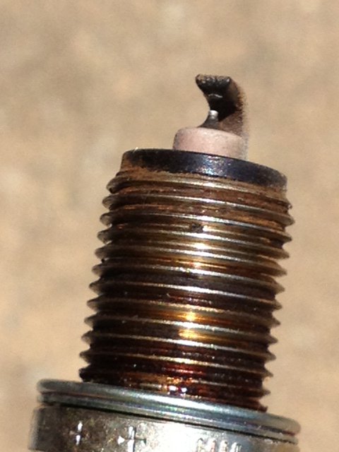

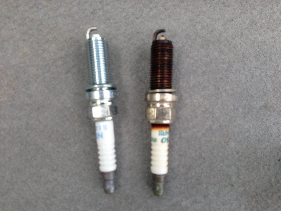

    So I work for Toyota in the Internet Sales Department and every salesman keeps telling me that spark plugs last up to 100,000 miles or more. I just run with it since Toyota states that it does but as a Prius owner I find it hard to believe something like this last that long. I replaced my spark plugs at 75,000 miles and you tell me if the sparks plugs are still good or does it need to be replaced? I replaced them from OEM Denso to NGK as I prefer NGK. New spark plug on left and old on right (75,000 miles) diff.jpg ngk.JPG

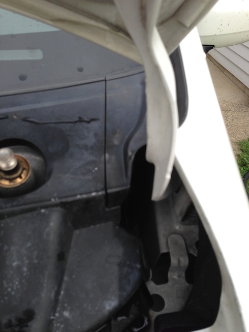

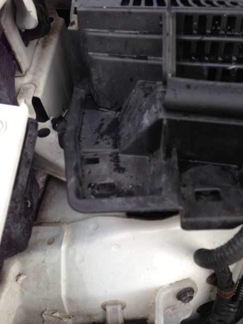

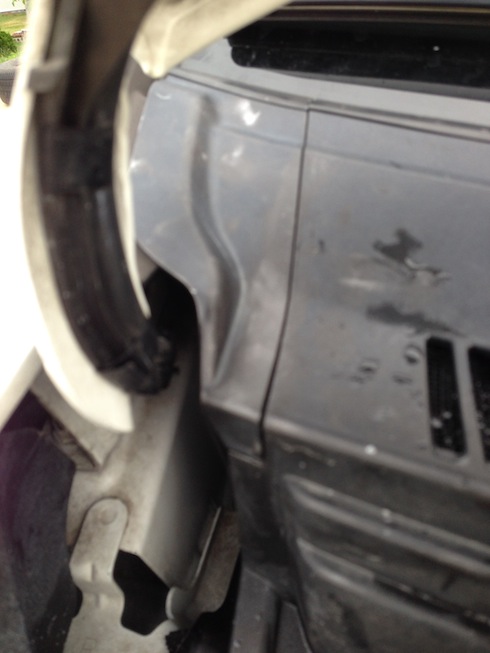

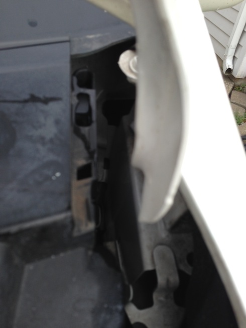

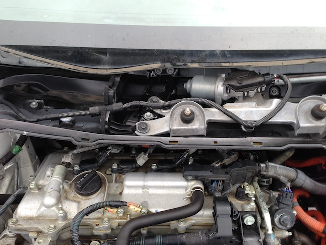

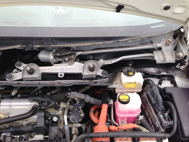

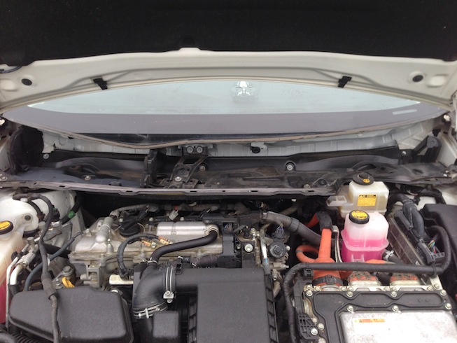

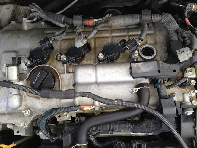

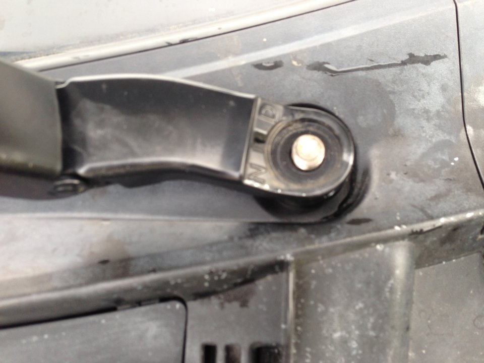

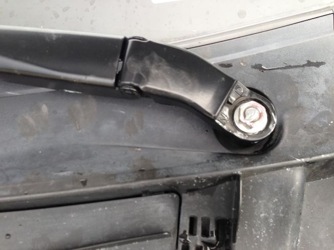

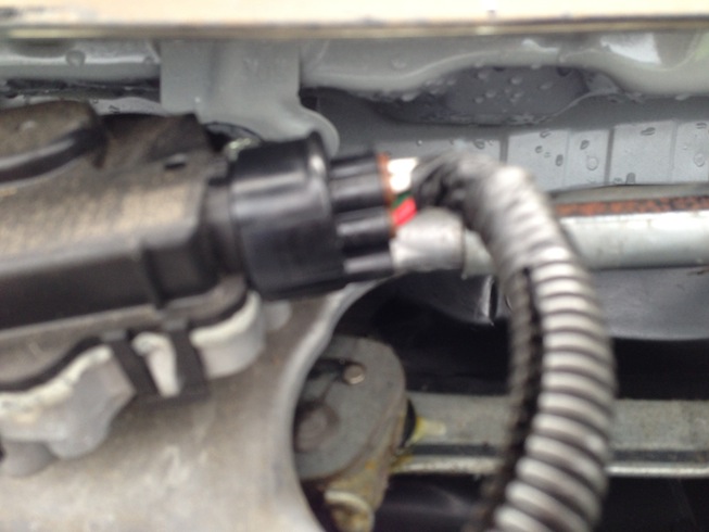

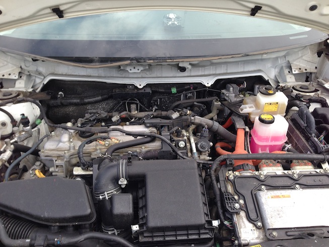

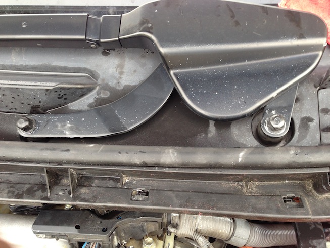

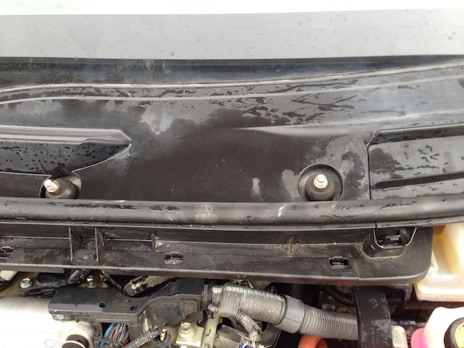

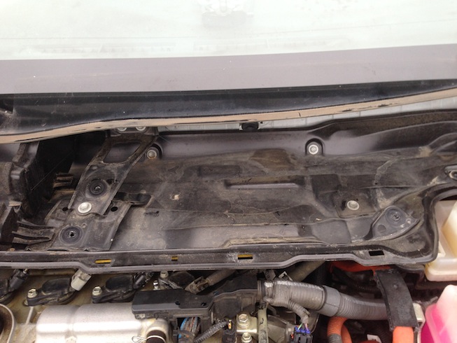

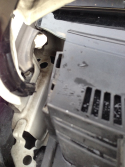

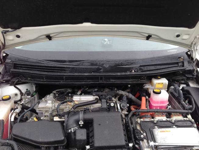

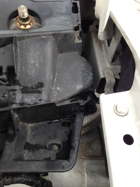

    Also here is somewhat of a step by step on how I took apart the 3rd Gen Prius. Note: You must find a deep socket that fits this spark plug as it was a pain finding some around my area. No auto or hardware store had them in stock.

    That's a 9/16" socket. It's a semi rare but available spark plug socket. Make sure it has the rubber insert to grip the plug.
    Nutzaboutbolts has a youtube video on 3rd gen spark plug access. Insane amount of disassembly required, shame on Toyota.

    i think the old plugs look fine, many here have pulled them at 100k and found them in excellent condition and perfectly gapped. i would wait until the recommended 120k unless i was having related issues.

    Unless the spark plug actually has a -failure- (seal, broken insulator, etc) what wears is the tip. If you look at the picture the old plug has almost as much tip as the new one. I think it looks just fine. Just a little dirty.

    The frustration with the OP's picture of the old and new spark plugs: it's out of focus. When you view the original size, larger image, it just gets worse.
    He doesn't mention any gap measurement. It's really hard to tell from the pic, but it kinda looks like the gap on the old one has opened up some.

    ....keep in mind the Iridium is a very special substance very expensive very rare more expensive than platinum, one wonders how it makes sense to waste this rare element on spark plugs. I'm keeping my old ones. I did not replace my Gen2 plugs until about 135k miles. Picture below you can sort of see how the plug metal is eroded but the Iridium is as good as new holding the gap. I saw no poor MPG with the older plugs. One way to think of it, it is sort of a waste of rare Iridium to replace too early.
