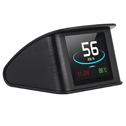

    You should install one of these P10 HUD unit:
    It plugs into your OBD2 port and monitors your engine temperature. Alarm limits are programmable and will beep at you. Your onboard warning lamp is set for 248F+ before it lights up, I'm pretty sure without an alarm. Normal operating range is 185F-210F, so early warning system when your electric water pump is beginning to fail. If you don't notice that coolant lamp flashing at you, you could pop the head gasket or worse.
