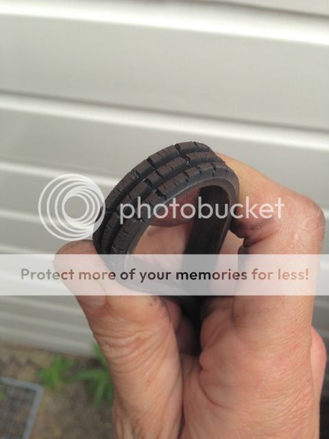

  12. Melchior
    Melchior Junior Member
    Feb 16, 2015
    74
    21
    Netherlands
    FWIW this was the belt on my 2007 Gen 2 last summer with just shy of 207.000km (128,000 miles) on the clock. Goodness knows when it was last replaced, if ever.
    It was VERY easy to inspect and change and VERY cheap to buy.

    Gates Rubber Co. is a leading supplier of replacement serpentine belts. They say:
    Be System Smart
    Inspect at 60K Miles and Replace at 90K Miles
    Be System Smart
    I replaced my 2004 Prius belts at 100k and at 200k miles at the same time that I replaced both major coolant pumps and the coolant fluid (also done at 150k and 250k miles). A bit risky on the belt but conservative on expected pump life.
    Then again the belt manufacturer does have a vested interest in us replacing belts often.
