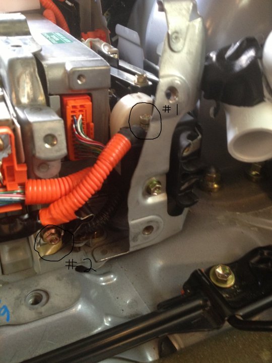

    I think I have them attached at the only possible place so I'm not sure what the problem is. I'm including a picture of where the wiring harness connects. #1 is the main connection and #2 is a black wire that appears to be a ground. HV connections1.jpg

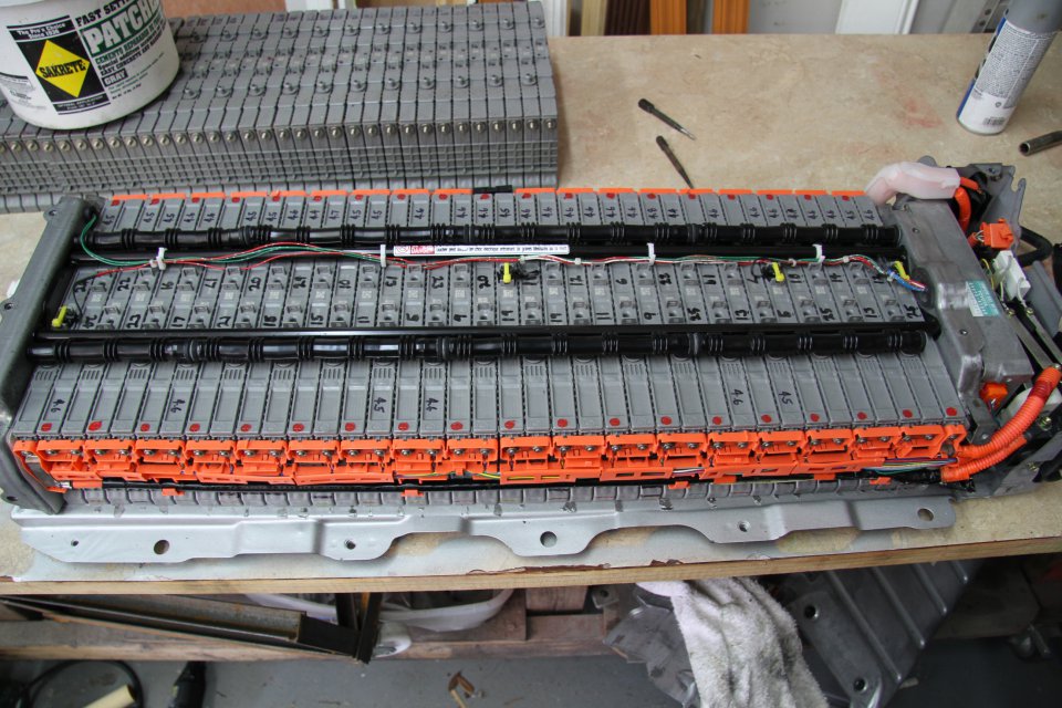

    you're missing the little short positive cable (5'' long orange cable w/ red tape wrapped on it) it goes over the last module terminal you see pictured (just North-North-West of #2) and attaches to the top of your relay (that screw directly above your #1).
    see this picture here:

    Thanks! From the picture it looks like that wire is part of the wiring harness, is that correct? If so, mine does not have it.
  7. dpeverhart
    dpeverhart Member
    Jul 24, 2012
    126
    23
    I
    Ok never mind my last question, you answered it already. It's a separate piece. However, I feel almost positive that this piece was not there when I dismantled the battery. This car had been worked on and they were unable to get it running before I bought it, probably because they were missing that short wire.

    you definitely need that cable and i wouldn't make one as you're dealing with 300 volts running through there. i'm pretty sure toyota will sell that cable.

    Today I picked up the short wire that connects from the last module to the relay and installed it. Car started right up and drove about 30 miles with no problems so far. Before I bought this car, the dealer said it needed a new battery. I bought a new wiring harness and the short wire for a total of about $150 and 5 hours labor and the car runs great!
