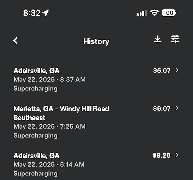

    I can not buy an EV equal to my 2019 Model 3 for $9,000. In fact, Tesla quoted "$8,500" as its trade-in value. So I've converted a rapidly deteriorating 2019 Model 3 into one with ~205 miles EV range and kept all the good parts I'd already put in to fix previous faults. Best of all, I still have Full Self Driving that I paid $6,000 for in October 2019. Let me share a practical experience today:
    • Drove total of ~416 miles to Tire Rack in Atlanta to pickup two new tires:
      • Reduced bill $20 by picking up the tires
      • Avoided another $22 of "overnight" charges by picking up the tires
    • Grinned and laughed at Atlanta Georgia traffic.
    • First and last segment EV charging from my home solar project, free
      • The last $5.07 could have been cut in half but I was eating brunch for me and the dogs
      • The first $8.20 could have been reduced by using the Marietta GA $6.07 charger, $0.19/kWh versus $0.32/kWh of Adairsville

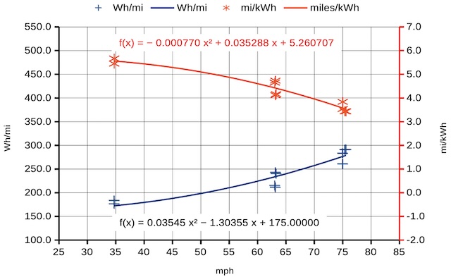

    The new tire performance will be added to the existing thread where I've already plotted the efficiency curves: (1) kWh/mi, and (2) mi/kWh:
    I prefer to use "mi/kWh" on trips.

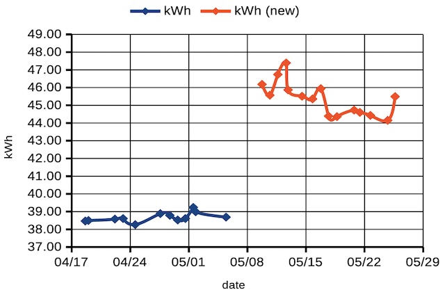

    Another view of the former and replacement battery:
    • Typically getting 4 mi/kWh
    • Adding 6 kWh * 4 mi/kWh ~= 24 extra miles, another 1/2 hour between chargers
    • 45 kWh * 4 mi/kWh ~= 180 miles
      • Car battery management system reports 204-210 miles

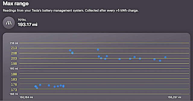

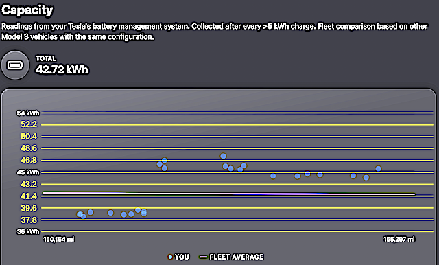

    I'm still mastering "Tessie" App that records metrics directly from the car. So here are two charts from Tessie:
    • The left dots are from the previous battery
    • The middle and right dots are from the replacement battery
    • Bringing the 100% SOC range to 203 miles
      • 203 miles / 50 mph (block-to-block speed) ~= 4 hours longest segment
      • I find 3 hours about as long as the segments I want to drive
