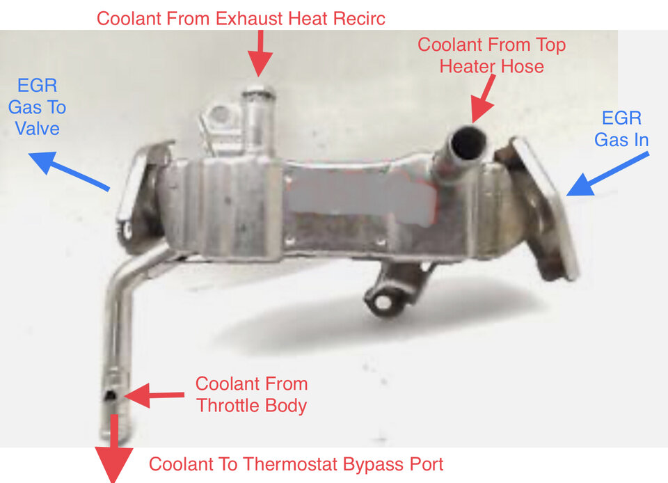

    Can you post a zoom out picture so we can see what the metal tube is attached to? It looks to me like the EGR cooler coolant port. Also, take a look at page#2 of the attached diagram. It might help you figure out what's missing.

    So based on the diagram that you should, its the larger hose coming out of the egr cooler. However, I'm not getting any help from Google on that.

    There should be four coolant hoses attached to the cooler. You have one missing. You may have attached it to something else.

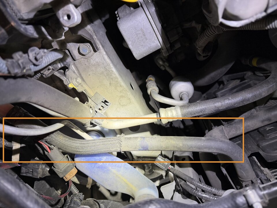

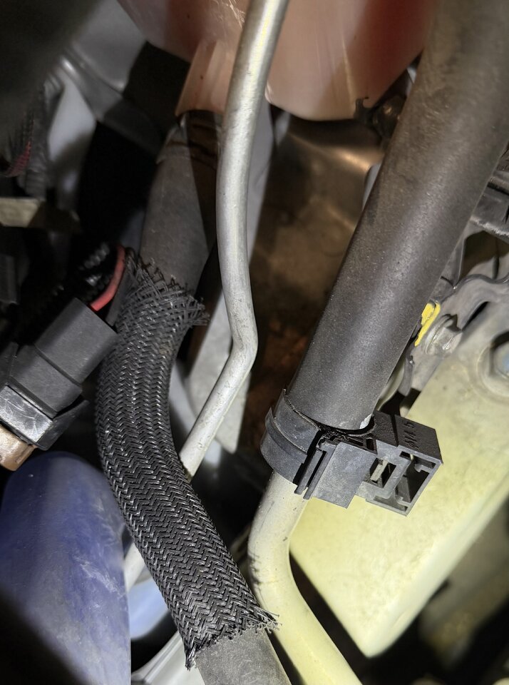

    As you requested, here's zoomed out photos of those areas.

  14. avoice217
    avoice217 Member
    Jul 20, 2022
    180
    22
    Hey rjparker, so I looked it up and found the hose. However, the split at the end I honestly dont remember.

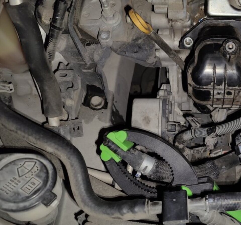

  15. avoice217
    avoice217 Member
    Jul 20, 2022
    180
    22
    Now any ideas where the hose that's connected to the green clamp goes by chance? I've been looking constantly and can't seem to figure out where to put that.

    Looks like bottom reservoir hose to radiator
