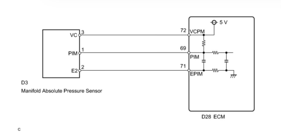

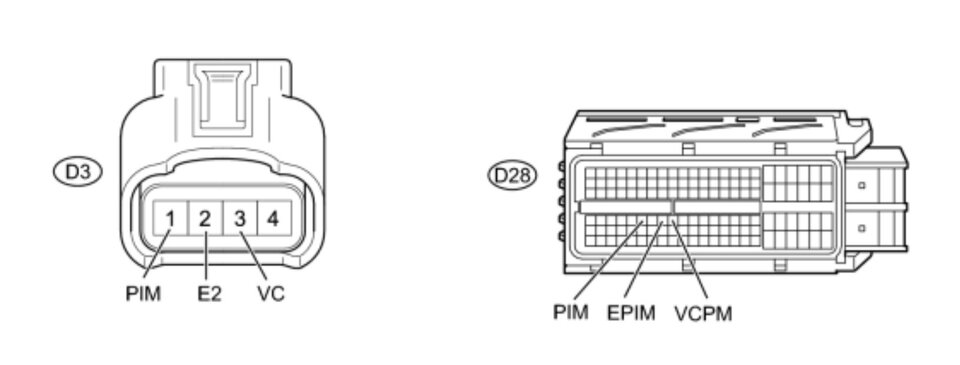

    Hey all, so here's the latest update. So I had my car towed to the only mechanic I know of that can work on my car. They took care of the spark plugs and I learned that I didn't tighten down the intake manifold enough. Now they're saying that the only issue I have left is to replace the MAP sensor and apparently there's some bad wires. However, I did some looking around and I can't find a wiring diagram for the MAP sensor. Can someone help me find that by chance? I can't believe that they're wanting to charge me $900 to replace the sensor and fix the wiring issue!

    The Denso sensor is $350, they may be suspecting wiring based on your PO108 and they may be planning on redoing your work to ensure everything is right in terms of gaskets, torque and connectors.
    For example, after you broke off one of the egr studs and then backed away from that exercise, it is possible some egr air leaks were left after reassembly. That alone would cause rough engine operation.
    I suspect their quote is on the high side and it could be far less if you have not damaged the map sensor with inappropriate solvents, etc.
    You should ask for a detailed parts and labor breakdown.
    The sensor wires to the ecm. If you decide to test on your own, be very careful as a blown ecm or damaged ecm connector will make a map sensor look cheap.
    I would have them repair the car.
