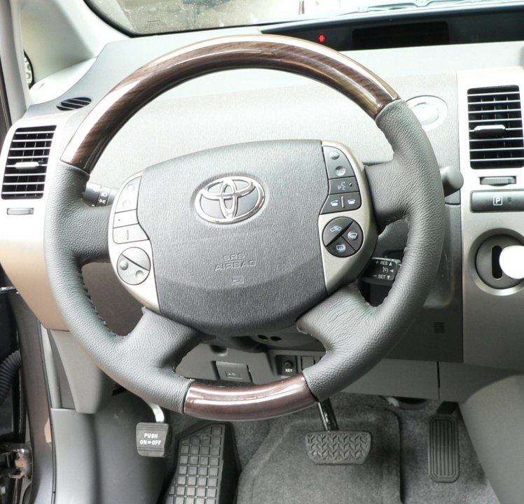

    I was lucky when I purchased my gen 2 - I happened upon a guy here on prius chat who had a steering wheel which he had purchased in Japan from a company that makes Lexus steering wheels....I paid him the $325.00 he was asking and had my body shop guy install it for $60.00....it was THE BEST upgrade I ever made on this car....was truely worth it! Later, my wife wanted one and I was able to find her one on ebay...it to was very nice and he personally made them. You have to ship the one you remove back to the guy you purchase the new one from. The guy on ebay was located in the Mid-West somewhere...don't remember where.

    Check out this post:
    new steering wheel for my Prius | PriusChat
    The seller may still be making customized steering wheels. I'm hoping so, because I'm in need of a replacement (mines starting to be really worn) and I always wanted to get one of the steering wheels that he makes. But just like everything else in life it's a matter of time and money. I usually just don't have the money...
