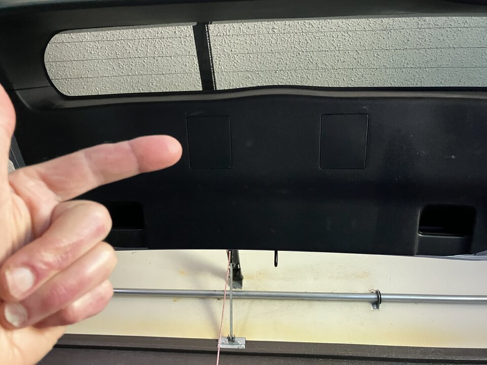

    3rd gen has a couple of small access panels you can pop out, you're not seeing anything like that?

    I don’t have 2 panels. I only have the one on the center for …I assume emergency opening of the latch.

    I have a small 2" X 3" access panel on the inside of the hatch opposite about the middle of the license plate. I don't know what is under that cover. The license plate illumination, LED on my vehicle, is inside the exterior garnish/trim piece that gets removed per the above attached instructions. For the OP, are your bulbs regular filament?

    That's a misstep. Gen 3 access panels:

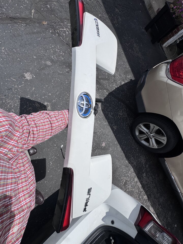

    My guide up there from Chilton's is correct in that you have to remove 10 10mm bolts from the inside and then pop off the exterior garnish.

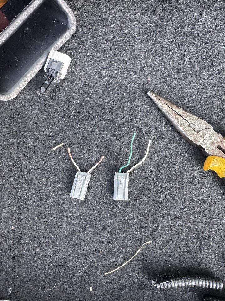

    I’m not through with this, I keep struggling on getting these lights to work. I’m certain that the old lights did not work, and with a multimeter and basic AI to help guide me- the aftermarket ones I bought are functional, though I have never gotten power to them.
    Does anyone have a diagram or know how these should be wired?
    It appears the wires that feed into the two plugs have a positive , and a ground? And it appeared to me that the ground was just a wire that went between the two plugs.
    I tested the plug on the right and if I stuck the red probe into the power side of the plug and the black on a spot of unpainted metal on the hatch, I got about 13.7 volts when I turned my lights on. On the left I got next to nothing.
    So it seems like there was a problem with the power coming in from the left, so that’s why I cut these plugs. Now I have tapped into the power on the right and supplied power to the left- connected the two lights ground wire, and nothing.
