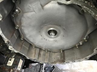

    My car is broken. I think the transaxle plate fell appart inside while on the motorway. Now it won't start at all, it just tries with electric hum and drains the HV battery. Fault codes cleared and nothing new comes up. But the real clue is the clunk and shudder as it tries to start. That bit started today, yesterday it was just locked. Today a clunk and judder. Very weird.
    What is involed in replacing the transaxle? Or at least to split it from the engine to replace the plate?
    Can this be done from underneath if I jack it up and drop it down?
    Or could it still actually be the battery? A P3000-388 came up after the break down (along side the cascade of faults that followed due to the catastrophic fail while giving it beef up a ateep motorway hill at 80mph.
    I thnk that was due to a little burn hole on a chip in the little BMS, that's replaced now. Not sure what the cause is here. I'm guessing the plate fell apart.

    I don't remember checking this on my gen 3, but some gens do have a small handhole in the blanking plate that comes down from the flywheel-end of the engine and closes the lower portion of the bell housing. There is a rectangular plastic plug that closes the handhole, and you can pop that out and feel around through it a little.
    Sometimes when the coil springs in the input shaft damper have been beaten to smithereens, you can feel fragments of them if you feel downward in the bell housing.
    But you described an electric hum and the engine not starting. You can get a first idea what's going on by standing at the right side of the car and watching the crankshaft harmonic damper (the thing that would be the crankshaft pulley if the engine had a belt).
    If your buddy pushes the power button and you hear the spinning of MG1 in the transmission and the engine crankshaft stays motionless, then you will certainly need the transaxle off to see what is broken; likely the input shaft.

    Might well find "bits" in there. I've never popped ours off either, but I believe that's what it's there for.
    With the engine off, if you rotate the engine (socket on the crankshaft at passenger wheel well), would the damper rotate as well? Or the park pawl prevents this, for starters.
  19. ChapmanF
    28,743
    19,041
    I think those blanking plates are pretty standard parts, probably shared with other cars.
    On a conventional automushic transmission, the torque converter might be bolted to the 'flywheel' (usually a much lighter/thinner version, since the attached torque converter can supply some of the mass) with bolts through from that side, and you might use that access hole to undo those bolts one by one as you turn the crankshaft around to present them.
