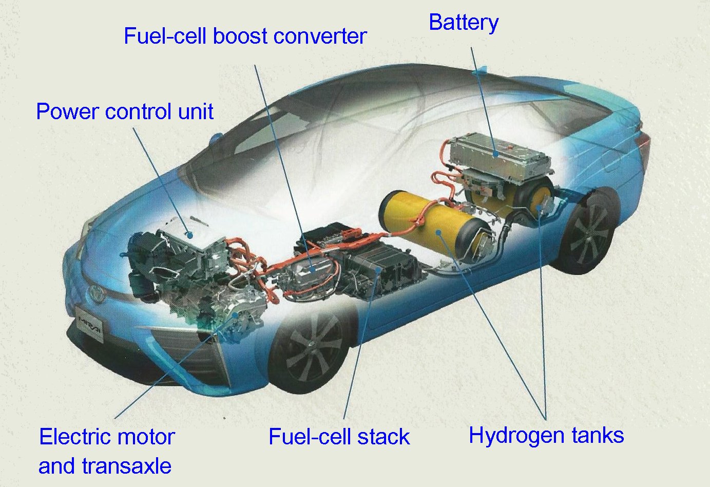

    The 5 minutes refueling is under optimal conditions; filling 5kg could take almost as long as using a Supercharger under worse case.
    A FCEV also needs space for the motor and attending equipment. The Mirai holds nearly 5kg of hydrogen between two tanks. Combined the tanks weigh around 95kg empty.
    Confining high pressure gases in more package friendly shaped tanks will increase the tanks' weight.

    5kg refueling will take under 5 minutes unless there's something wrong with the system or it's under-designed. There's no technological reason it would take more than a few minutes. The intended goal is 2kg per minute.
    The Mirai needs that giant fuel cell because that's the main propulsion for the car. If the battery is the main propulsion, like it can be in the Prime, the fuel cell can be smaller by a factor of about eight.
