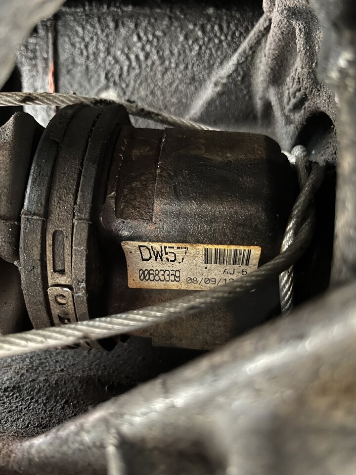

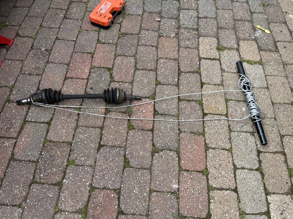

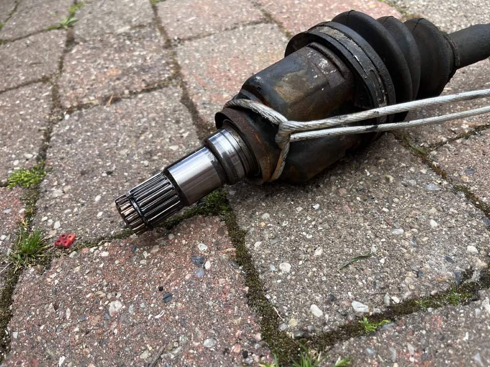

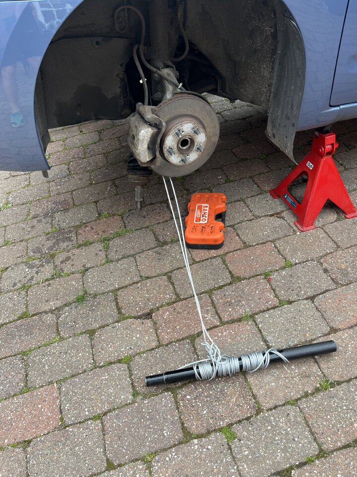

    I have no Vice Grip and no slide Hammer. Looked for a cheap alternative solution with no boot cutting hassle.
    Alternative cheap solution:
    Space is narrow.
    I decided to sneak a steel wire around the CV joint mount. Leading the strands out to the side of the car, wrapping it around my Jack Handle.
    Hereafter doing some “Power Rows” - ca 20 of them. While also alternatively turning the axle in order to maybe loosen the snap-ring to a favourable position.
    Pictures for demonstration.
