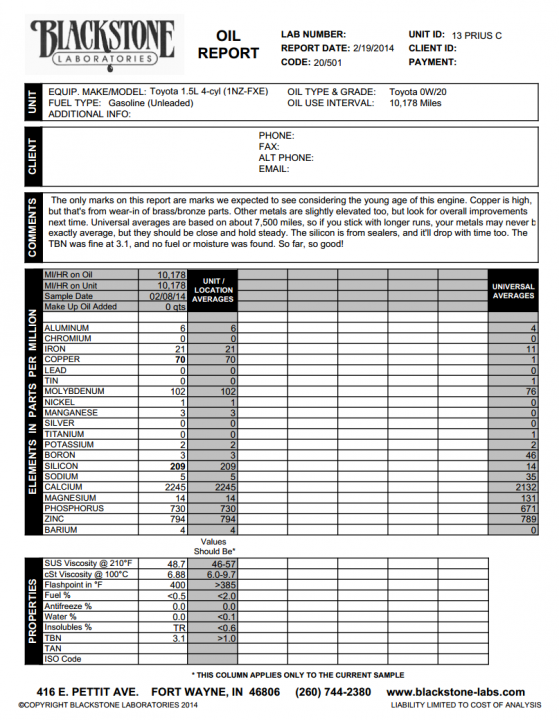

    1st oil change @ 10k miles - I've put the results below in case anyone is curious.
    I added the TBN measurement, if you don't know what it is:
    I'm not going to be extending my oil change intervals but it's still nice to know how much active additive is left after 10k miles.

    (y)
    VERY nice for 10k and the first OCI!

    Can someone explain this in non-technical terms?

    pretty much a breakdown of what kind of things were found in the oil

    Here's a quick summary of what to look for on an oil analysis.
    HotDogWater's oil looks good, as long as copper trends down over time and no other trace metals like tin or lead start to show. It'd be unusual to see much more on a new engine.
    Engine Oil Analysis - Bob is the Oil Guy

    Aluminum 50% high
    Copper very high
    Silicon very high.
    Moly high but indicative of additive content; good.
    Cu and Si are indicative of bearing wear as I remember.
    Couple others are higher than typical but I don't see much problem but Cu and Si can be a problem.

    The report indicates some wear in bearings but doesn'yt look serious yet; Other wear analysis components look pretty normal, even those that are a toward the high side of the normal range. And its not unusuasl for silicon to be above usual in first 10k as the rings wear and bed in. The thing to be aware is any change in those bearing materials as time goes on, particularly Cu and Si. One thing to be carefulis the hardship the engine has seen. The more an engine is stressed the more the wear.
