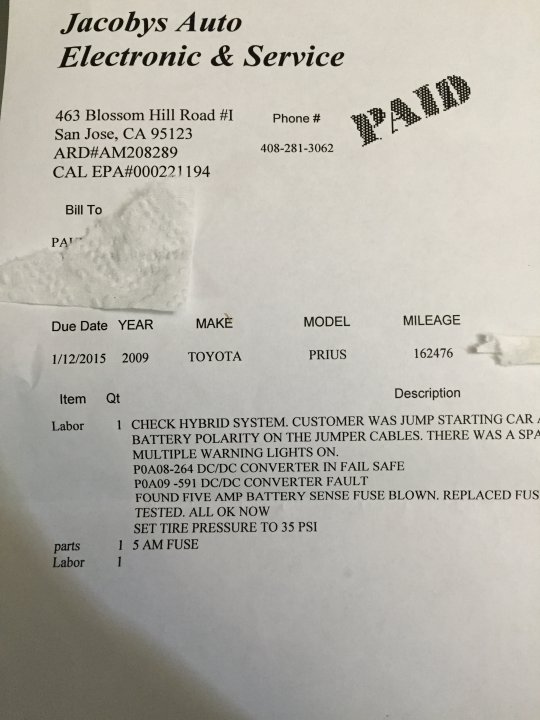

  8. Former Member 68813
    Oct 3, 2010
    3,524
    983
    US
    i saw this posted in the 2 gen forum:
    Cosmo Tigato and Mendel Leisk like this.

    That information will help the OP.
    Story will be to find the fuse.................................

    Even though that Gen 2 problem was for a CHECK HYBRID SYSTEM warning, I double checked the 5A battery sense fuse and confirmed it as good, both visually and via a resistance check inside the fuse box under the hood.
