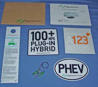

    I just got my Hymotion welcome package today. Here is what it includes.
    Inside the envelope there is an updated instruction manual, a quick start guide that looks like it can hang on your rear view mirror, a square 100+MPG sticker that looks like it will fit on the gas door, a Hymotion window sticker, an oval PHEV sticker and a Hymotion logo "H" keyring.
    I have scanned in and uploaded the new manual. This is reversion 03.
    http://stuff.jaygroh.com/priuschat/brem/Hymotion L5 User Guide V03.pdf
    All this information will also be posted in my first post when I finalize everything.
    Kent I cant wait to hear your experience at Fitzgerald and with your new PHEV.
