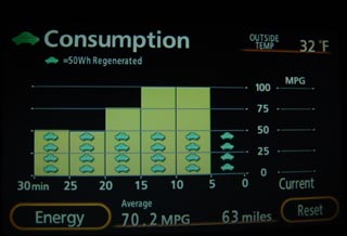

    I have a new issue that just appeared tonight. Maybe someone here can explain this picture. This picture was taken after my normal tip from my bowling league. I did not ride the brake and unfortunately it was not all down hill. I will be sending this over to the techs at Hymotion to see what they say.

    Wow, that picture is kind of funky. If you had that much regen happening your regular NiMH battery would have been at 8/8 bars. Let me know what Hymotion says.
    I really like how you are tracking your electricity costs and including that in your numbers.
    Have you noticed when the NiMH Toyota battery is full from regen (8/8) it beeps at you that you cannot enter EV mode? This happens to me a lot in the morning because I descend a 1/2 mile hill every day. By the bottom of the hill I would be forced out of EV mode every time if I have the Hymotion engaged.
    So to get around it I start with Hymotion off and drain my NiMH battery to 5/8 on a flat area before I start descending. Then it is typically at 7/8 by the bottom of the hill. I continue driving until the regular NiMH battery is down to 5/8, then I flip on the Hymotion battery at a stop light. I typically drive 2 miles in stock EV mode before I even turn on the Hymotion battery in the morning.

    I think I found the issue with the regen. I added some gauges to my ScanGauge the other day and that was the only change I made to the car. I noticed that the non passive AMP gauge did not work correctly. While leaving it up on the screen the MFD would show max regen for each 5 minutes. When I took off the AMP gauge the MFD would display normal regen.
    I thought before I had the battery installed this AMP gauge worked correctly. I have not heard anyone else have an issue with the AMP gauge Pre or Post Hymotion battery installation. I also tried the passive AMP gauge but it also does not work correctly but does not cause the regen error.
    I might need some help from people with and without the Hymotion battery and that has the ScanGauge to see if this AMP gauge effects a normal Prius and if anyone with the Hymotion battery gets the regen error.
