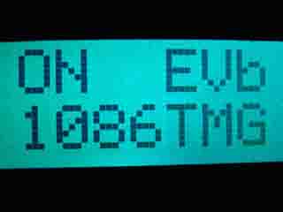

    This is what I've been wanting to see. I let S1 complete and I was able to EV it all the way home. I wish I could do this all the time. I had to take this picture quick because every 20 seconds or so the MPG would drop about 30MPGs because of the GPH bug. Because of the bug I know this number is a lot higher. How high I don't know. I wish SG would fix this bug. I would gladly send in my SG to have it reprogrammed. Heck I would even buy a new one and give this one to my parents since they do not have a hybrid and the bug should not be a problem for them.

    I don't think I'd be in any hurry to try this. If you run out of gas, then run your Hymotion and OEM pack down, you may be getting towed to the dealer so they can hook up their special Prius Charger for People Who Ignore the Flashing Low Fuel Warning Pip and Don't Refill IMMEDIATELY, all while the dealership owner makes another yacht payment and the techs have a good laugh at your expense. But hey, if you like living life on the edge, go for it! Maybe the Hymotion charger would get you off the hook and save the day. Who knows?
    You could always do like George at Hybrid Fest - look for the friendly neighborhood light pole that just happens to have an outlet at the base. You're in country where block heaters are not especially uncommon so there should be some public electric outlets scattered about if you poke around for them.

    I had another really good trip home tonight. 1186MPG according to my SG. Sorry I just had to make it big and bold. :p Same thing as last time. Go through S1 and EV it home at about 32mph. I think I might have to request to work straight evenings from now on. :) But I guess then I would never get anything done because I would sleep in until about 1:00pm, then leave for work at 2:20pm, and then do the whole thing over again. Evenings are great because I get paid more and get more MPGs but I just cant get anything done because I'm to lazy to get up.

    I just got my scangauge and I'm going through setup. Can you tell me what these 'displays' are. I assume they are xgauge. I had my son read the stock SGII during a short trip and 3500MPG was very consistent in EV mode. Also it almost appeared that the MPG read higher at a higher speed. i.e. at 30MPH it was ~2700MPG while 40MPH was ~3700 MPG. May just be me :)
    Thanks
    Chris.
  15. TheForce
    May 30, 2005
    3,461
    537
    Wheelersburg, Ohio
    Yes these are the xgauges. Go find Dan's scan gauge for dummies over on cleanmpg to see his list of stuff you can program. The instruction manual that came with the SG tells you how to get your trip MPG as a gauge.
    You will see higher MPG with higher speed in EV mode because of the GPH bug.
