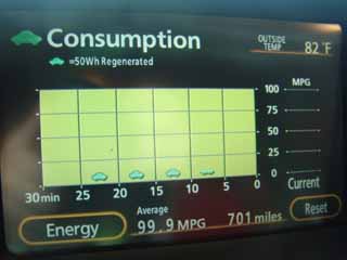

    I ran my regen test today and here is what I found.
    I started with a SOC of %60 at the top of a hill then coasted down putting about 60amps into to pack while slowing down to a stop.
    First run was with the stock battery. The SOC after the run was %72.
    Second run was with the Hymotion pack enabled. The SOC after the run was also %72.
    So it looks like the stock battery ECU does not care what the spoofed SOC says. If it says it can take the regen it will.

  11. miscrms
    miscrms Plug Envious Member
    Aug 21, 2007
    2,079
    527
    Phoenix, AZ
    Cool test, and very cool pic! I think there is one of two things going on here. They are either moving the spoofed SOC around based on conditions (as I believe cal-cars does), or more likely they are decoupling the spoofed SOC and CDL/CCL. As long as the charge/discharge limits are high, I believe the HV controller will keep putting in charge or taking charge out. I think its up to the Battery ECU to decide when to lower the limits (if they're not being spoofed too) and it wouldn't care about the spoofed SOC, only the real SOC of the oem pack.
