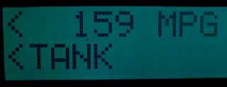

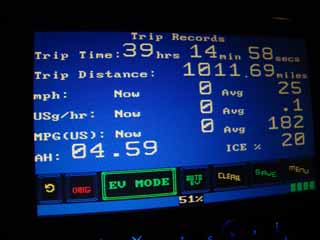

    OK so here is my 1000 mile update.
    I have 1000 miles on this tank so far and everything is going OK. The CAN-view is showing %40 left in the gas tank and 182MPG. The Scan Gauge is showing 159MPG for the tank.
    The only issues I have are with the AUX battery. I accidentally drained it one day with the car in AAC mode and now I think its damaged. Normally I can run my car PC for 10-15 minutes in AAC with no problems but now just running it 5 minutes drops the voltage well below 11v. I found the car wont start if the voltage is below 10v but will start if its at 10.5v or so. So now I have a Optima yellow top battery on order for a replacement. I was planning on getting one next summer but since I damaged my stock battery I figure I better replace it before it gets too cold out. I'll have a small SLA in the trunk to use as a jump battery in case I need to use it while I'm waiting on the Optima to get here.
    I don't think I will reach my 1400 mile goal because I took last week off and I'm taking next week off to. I don't plan to do much driving during my time off. So I guess my next update with be on October 12th sometime or even the 13th. It just depends on when I get back from Cincinnati.

    Can you explain why there is a discrepancy between the two gauges? Which one do you put more faith in?

  17. Flying White Dutchman
    Dec 29, 2007
    4,374
    313
    so over those 1000 miles your avg speed is 25mph thats not a lot...

    The ScanGauge reports .01 GPH even when in EV mode. So it thinks I'm still using gas when I am not. I trust that the CAN-view is more accurate but we wont really see until October 12th when I fill up.
    That average includes all the time I have spent with the car in ready mode and not moving. Not moving because of red lights, stop signs, traffic, and just sitting working on my computer for a few minutes a day. My true average speed for my commute is about 32-35mph.
