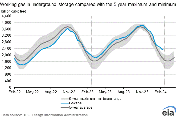

    Okay Bob, read this:
    Weekly Natural Gas Storage Report - EIA
    Specifically, this:
    Let me do the math for you. The difference between the peak and the trough on that chart is around 1 million gigawatt-hours of net seasonal energy storage. Now, imagine you have to do that using batteries. A giga-factory is, what, 150GWh a year of total production? How are you going to do seasonal energy storage using batteries?
