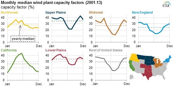

    There is a seasonal cycle to electric use in the US, with peaks in the summer and winter. While solar energy will drop off in the fall and winter, that is when wind energy will pick up for most of the country.
    Wind generation seasonal patterns vary across the United States - Today in Energy - U.S. Energy Information Administration (EIA)
    The need for grid storage is more pressing on the daily level in the US than on the seasonal, and batteries are proven to be effective for that. And again, we aren't limited to hydrogen as a storage medium.
