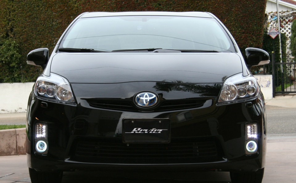

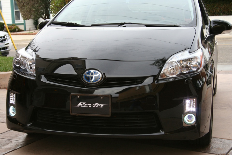

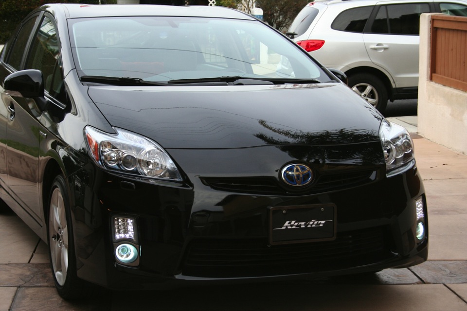

    I've installed the other side and taken some photos of the DRLs in the daylight. The bulbs I ordered are supposed to arrive in a couple of days, but I'll be out of town by then until after the new year so that'll have to wait.
