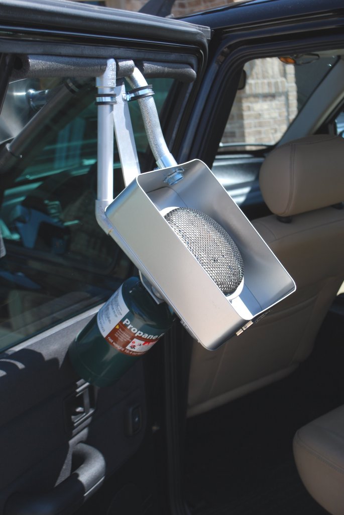

    Want more heat than a chintzy 12v plug can provide? I'm not saying I'd ever approve of this . . . but . . .
    what with proper venting and all ... definitely not for me. Still, it's pretty clever, after you get past the creepy factor.
    :LOL:
    markabele likes this.
  15. El Dobro
    El Dobro A Member
    Jul 12, 2011
    7,106
    3,282
    You can also keep the burgers warm, too.
  16. hill
    21,530
    9,041
    Yea !! Just make sure you carry a fire extinguisher . . . . . maybe a carbon monoxide alarm too.
