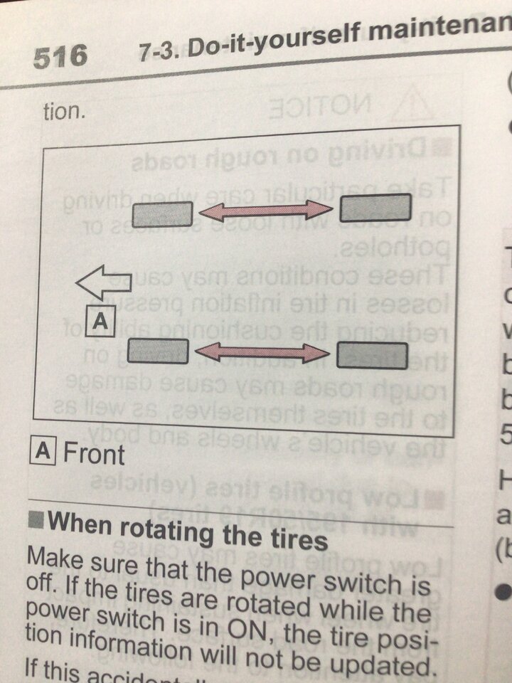

    The manual clearly calls for Front to Rear tire rotation - no cross rotation. IMG_1296.jpeg

    I have been putting 2 jacks on one side and doing the tire rotation per the manual. I also have ramps for the oil change.

    The US manual, yes. The European one shows cross rotation.
    I don't think there's any deep significance there - I'm going to guess that they don't want liability if a US person does a cross rotation with directional-tread tyres.
    I've been cross rotating the original summer set, and front-to-back on the directional studded winter set.

    Interesting. I’d always cross-rotated our Honda, per manual, then didn’t, with our previous, again per manual. Googled the following:
    why does toyota not recommend tire cross rotation in north america
    Yields some explanations. Think I’ll just carry on per manual.

    Okay, interesting information. I will consider crossing mine too. The wear rate on my Toyos, so far, has been pretty low.

    Found myself wondering, so just checked - "original" Japanese manual also shows cross rotation. US is the odd one out.
