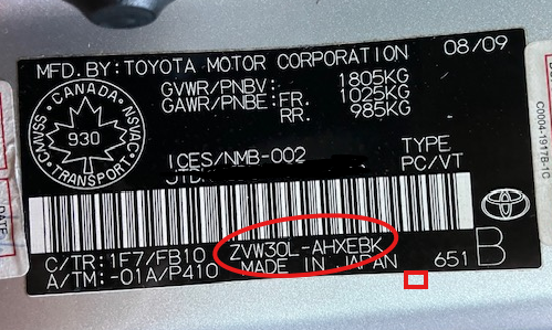

    What's your car's "frame number", this, on the driver's door decal:
    Amayama "may" have it. If price/shipping is prohibitive, at least it's good to know the part number(s).
