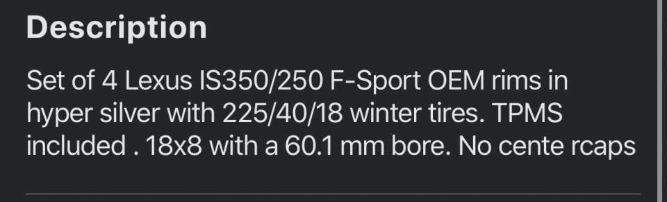

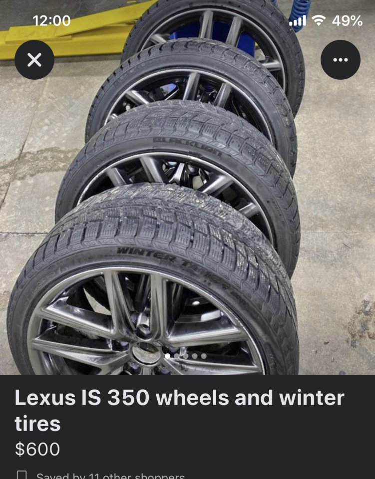

    18s would look awesome, any tire gurus here? Thx

    No, they won't fit. They have a 5 x 114.3mm bolt pattern.
    The Gen 3 Prius has a 5 x 100mm bolt pattern.
    The 5 x 114.3 bolt pattern would fit the Prius v wagon and vehicles like the Toyota Camry, Rav 4,
    and Highlander.
