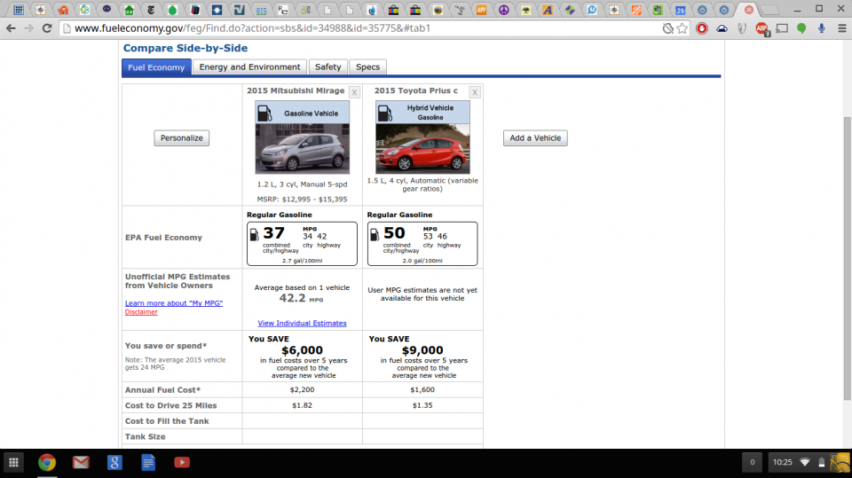

  14. roflwaffle
    roflwaffle Member
    Feb 23, 2012
    381
    77
    Orange County
    That's about right. Using the fueleconomy.gov defaults for your 30k miles/year I'm seeing payoff in ten years/300k miles per the attached screenshot. That excludes any advantages in maintenance (few/no brake jobs) and possibly better reliability.
    I think you're confounding one thing. People in densely populated metro areas will have short commutes with more city driving, not longer commutes.
    The higher insurance premium also reflects a higher residual value (More value to insure), and my guess if the higher residual value of the Prius C is what someone is paying for. It's also the advantage if/when they sell the car or it's in an accident.
    The insurance premium also won't always be $1000/year unless the driver has a really crummy record. It'd start at ~$1000/year and decline to ~$100/year at the end of a decade IME. It still eats up a big chunk of the gas savings, but not all of it over 10 years, and at 10 years the C will almost certainly be worth thousands of dollars more than the Mirage.
    I'm not a middle aged suburbanite. I'm thirty+ living in a region with a population of 3+ million, and if a Prius C is less expensive for me then a Mirage, it's likely less expensive for the majority of drivers.
    I suspect it's less expensive even for very young (~20yo) drivers even after the higher insurance premiums if you were to include the greater residual value. It'd be neat to throw in a spreadsheet to examine in detail.
