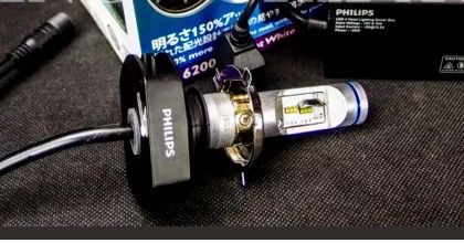

    Anyway these LED look promising given the above pictures, I'm hoping they become available here. (I made a few more trips since then and the cars with aftermarket / non compliant LED fitted to their reflector headlights are a serious hazard)

    I reckon the +130% is achieved by using a thinner fillament, maybe by using a better material... I'm unsure, but the wattage should be the same and one thing's for sure, they do not last long. Those LEDs would provide a nice battery performance boost in heavy traffic at night I suspect.

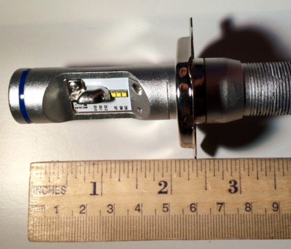

    purchase and easy installation impressive, I'm afraid that the different versions did not fit our Prius as the Philips LED disassembled for parts

    I've spent over $600 trying to get Philips LED lights setup with my Prius. Those Ultinons with the big black heatsink are a no go with the gen2 Prius as another poster has showed. Without the heatsink properly attached the LEDS will get too hot and reduce there brightness (and life).
    I spend more money trying to create my own heatsinks with a block of aluminium and tapping a thread so i could screw it onto the LED, but due to the prius headlight housing angle i could only have a small circular heatsink that was not effective enough compared to that Philips black heatsink.
    So today I bought the newest Gen3 Philips h4 Ultinon 9000, the heatsink is smaller and circular with active fan cooling. This almost fits but fouls on the plastic ring rubber boot part.
    I will create a post shortly showing how I modified this to fit these LEDS without ruining the weather proofing.
