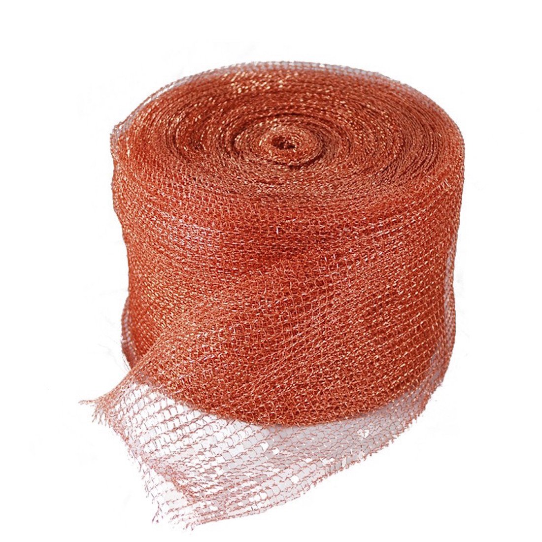

    that's what I did to my wifes subaru after presumably a mouse was biting through some wires in a really hard to access location & the car was throwing all kind of dtc's/
    pretty much all wires (at least the visible to me ones) are wrapped with copper mesh (& secured with zip ties)/
    no rodent problems the last 4 month.... :) //

    seems so, buy it's not.
    that's what I had first in mind, but after getting the car on ramps & checking the bottom I thought it would be easier & quicker to wrap the visible wires/cables.
    a good hour & everything was said & done/
