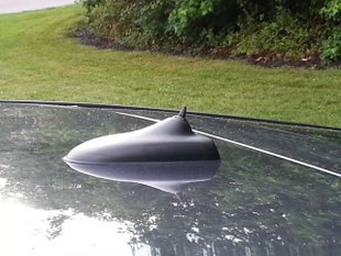

    :)Originally, I didn't think the Prius roof antenna was unsightly or out of date. Recently, I considered going with a shark fin antenna for a better look. Then I had a revelation. Why not remove the mast antenna and keep the base? From a short distance it looks like a variation shark fin
    antenna. I NEVER listen to AM-FM, so loss of those signals is no loss. The cost of a shark fin antenna is insignificant, but free is best.
