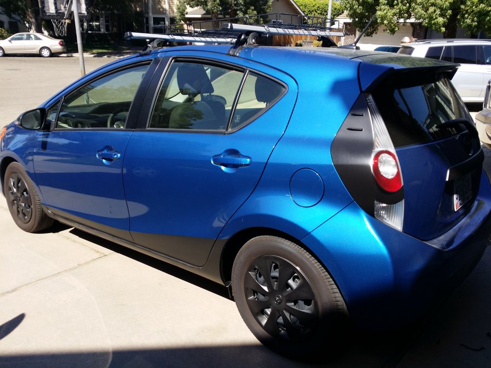

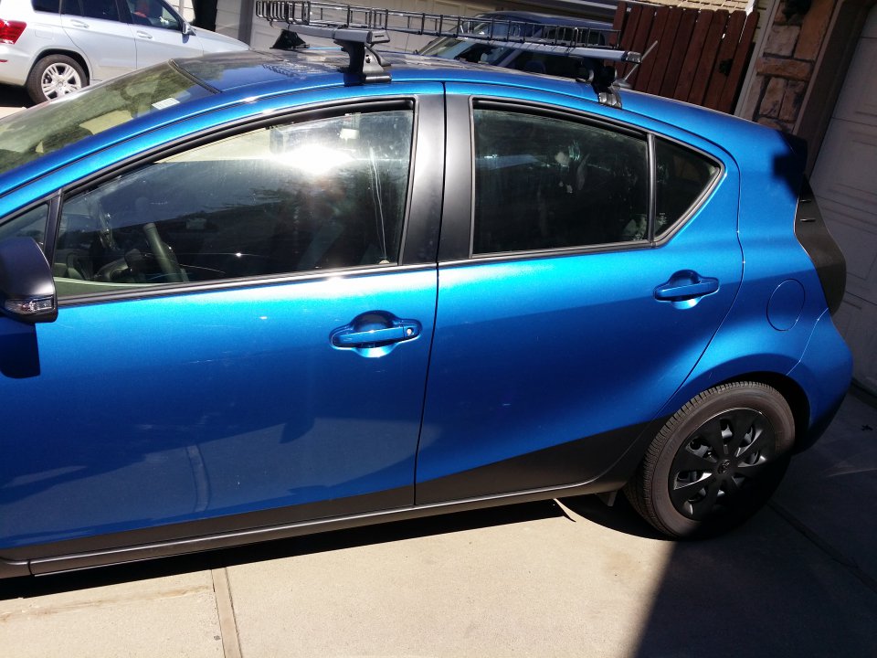

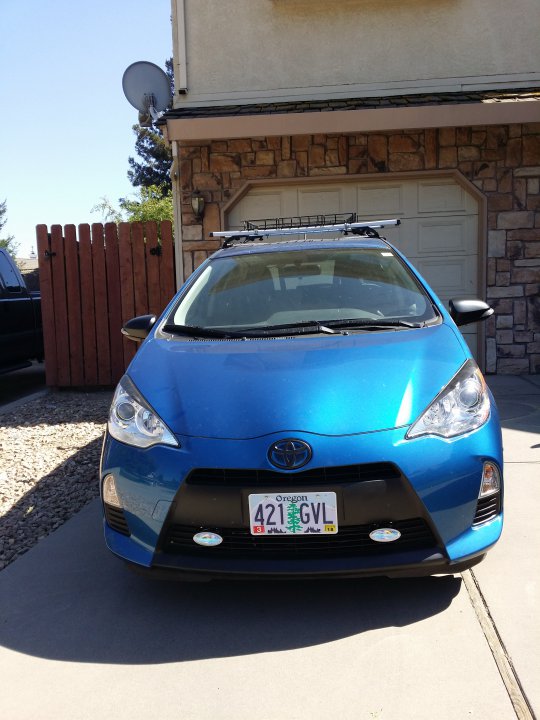

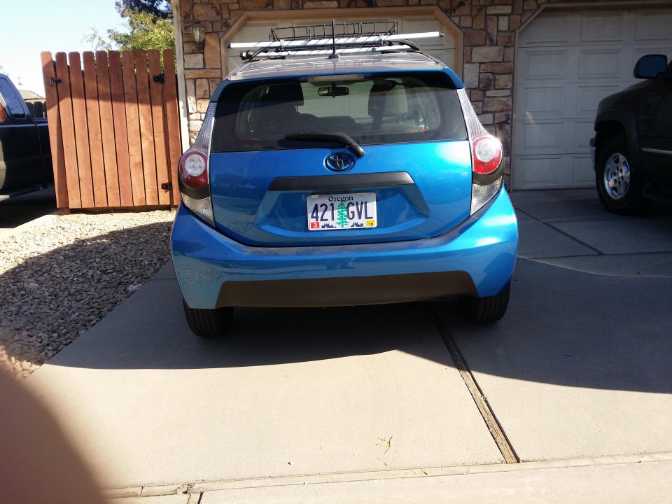

    I'm relocating from Florida to South Dakota for a job and just bought and installed a Rhino Rack 2500 with euro square bars last night. The roof rack was a little time consuming to put on but once you get it set up it only takes a few mins to take off or put back on. I will give an update on how it held up when i get to SD.

    I ended up buying a universal rack on amazon for 69$ shipped. I had to use 2 different braces for the front and back. I also had to use my yakama cage to keep the 2 bars from sliding towards each other. have had it on the car for over 5k miles so far and have done a road trip of 650miles with it loaded. every day use I avg 32miles each way 17miles freeway rest in town. I get 48mpg per tank without rack, 47 with. when I had it fully loaded for my road trip with the interior loaded I avg. 41 mpg. beats taking a 2nd car or renting a bigger one.
