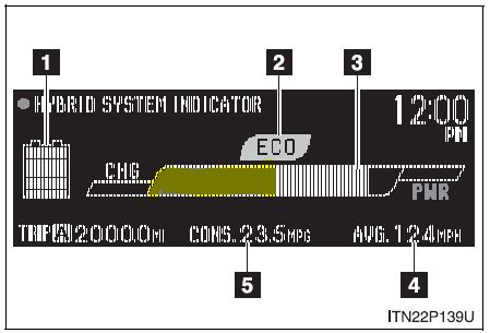

    What you can do, any time while driving, and this is outlined in the Owners Manual: lft off the gas, then gently re-apply, keeping the HSI display to the left of center (yellow zone). This will shut the engine down momentarily, and use electrical propulsion only. This is a short term, takes advantage of circumstances (light loads, lower speeds), works at moderate speeds, is locked out above maybe 70 kmh.
    And you shouldn't overdo it: once hybrid battery status drops to around 50% I wouldn't actively pursue it. If you do run the battery down, it'll just lock out this on-the-fly electric-only propulsion, and start running the engine even when you're stopped

    The default display, likely what you're seeing since taking delivery, is:
    You need to push the display button on the steering wheel a few times, to show the HSI display.

    The reason there is a battery is to provide acceleration energy. The engine in the Prius is very efficient (relatively) but provides poor low end performance. The battery/MG combination helps overcome this. The EV mode you get into by pushing the EV button is, as noted, not especially useful. However, anytime the car is warmed up and you are doing less than about 45mph, you will go into EV mode (engine off) any time you get the power bar below half way on the system indicator. At this point, your mileage is around 1500mpg, which is why pulse and glide works so well in the Prius. Unfortunately, you are also slowing down and have to eventually accelerate, which is why you don't get to keep the 1500mpg.

    Well almost. Just to qualify that: if you've got all the above conditions, then lift off completely on the gas, then gently re-apply, keeping to the left of that halfway mark, you got very good odds of the engine shutting down, using electric propulsion only. And yeah, even without the lift-off-and-reapply tactic it'll sometimes shut the engine down.
