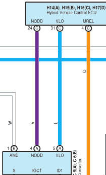

    Take a look at this post. There are two signaling circuits between the DC/DC converter (contained in the inverter assembly) and the HV control ECU. They're called NODD and VLO.
    Try to get the INF code for your P0A09. If it's 265, it's about the NODD circuit. if 591, it's about VLO.
    Check the wiring before replacing the inverter. I don't care how cheap they are on eBay, nobody likes replacing a big heavy $$ part and then fixing a wire.

    I never wondered why no P0A08 ... you have a P0A09, they're separate codes, they don't have to show up in pairs or anything. Just because somebody else in another post had a P0A08, you don't have to.
    For the P0A09 that you do have, though, it is strange that you can't get the INF code. That would tell you whether to look at the NODD wire or the VLO wire. If you can't get it, well, just have to shrug and look at both.
    It's not much use to spend time on "seemingly what the code description seems to imply". Need to look in the manual and it says what the code means. P0A09 is about one of these two wires (depending on the INF code) between the converter unit and the HV control ECU.
    INF 265 means it's about the NODD wire. 591 means it's about the VLO wire. Whichever INF code, so whichever wire, the code means the ECU thinks it might be open-circuited or shorted to ground.

    And before you fuss with any of that, check the NODD and VLO circuits that your trouble code is about. Those are ordinary low-voltage auto-electrical circuits. They won't hurt you, and you can check them with your multimeter.
    It's hard to figure out where you're getting this. There are two wires involved that run between the converter and the HV control ECU. One is purple and one is blue and they look like wires, and the ECU is saying one of them might be broken or shorting to ground. If we had the INF code and it was 265 it would be the purple one, 591 it would be the blue one. I'm looking right at the manual as I type this. Checking a circuit for a break or a short to ground is something auto electricians have been doing since long before Priuses. We don't have to make guesses about low power or what not.

    The inverter/converter assembly has both: high-voltage connections (those are all fat and orange), and also ordinary automotive low-voltage connections that will not electrocute you. You'll see connector C5 on it somewhere. It will have wires of several different colors, including a purple one at pin 4 and a blue one at pin 5.
    The wiring checks the manual would have you make are with C5 unplugged from the inverter, and H16 unplugged from the ECU. You can unplug those without worrying about anything high-voltage. Those are the ordinary low-voltage control circuits for the inverter and converter.

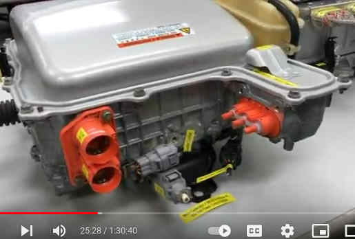

    If you look in Prof. Kelly's video, you can see the light gray C5 connector on the back. The one above, with the multiple wires.
    The light gray one below it, with just one fat white wire, is the converter output.
    I'm looking in a 2006 wiring diagram where the NODD wire, C5 pin 4, is purple. If you've looked at a different year and it's not purple, they may have changed the color. It happens sometimes.
