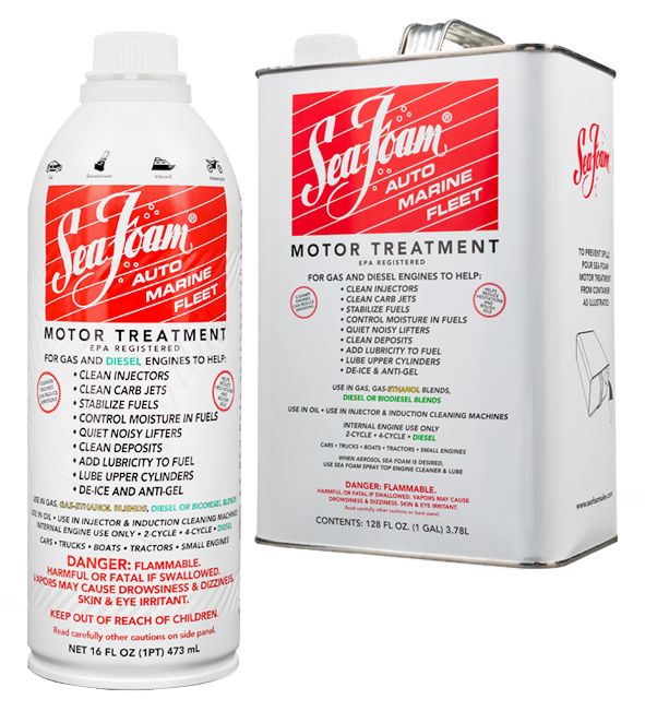

    Some people put it in the oil too. DON'T! If added to the oil, it can knock sludge deposits loose which can then plug coolant ports and wreck parts of your engine.

    Mike, when you mention that you used 6 bottles of Seafoam, was it the type that you pour in the gas? Or was it the cleaner that you spray into the throttle?

    Pour into gas tank.
    Also bought Mass air flow sensor cleaner which
    appears to have eliminated cold morning engine chatter.

    Did you put in 6 bottles in one tank, or 6 bottles over 6 tanks? Or other? I would like to try this.
    As for me, I ran 1 bottle of Seafoam high mileage at half tank, ran until fill up light. No mpg difference yet :/

    I poured one 16 ounce can of Seafoam per 10 gallon gas tank in 2010 Prius.
