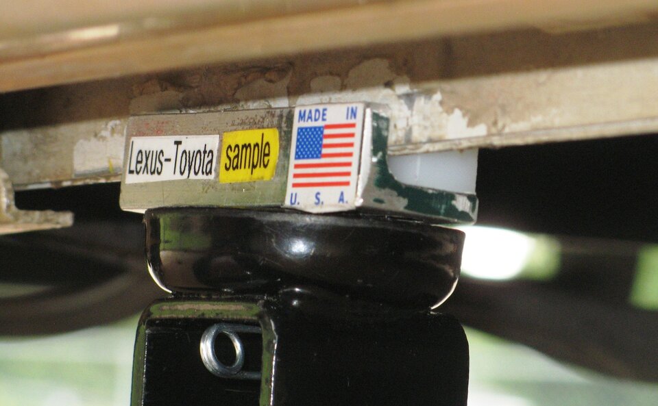

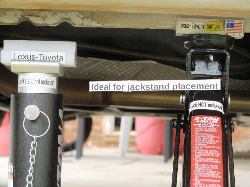

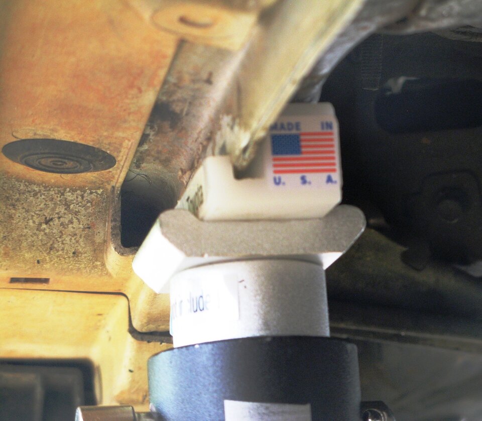

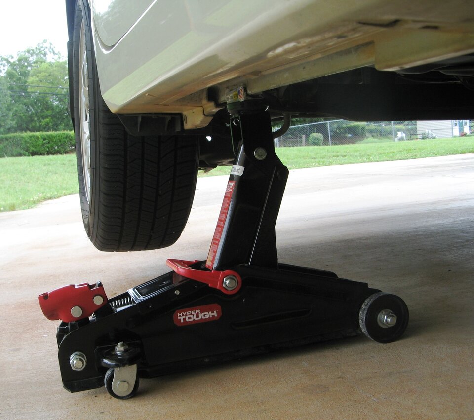

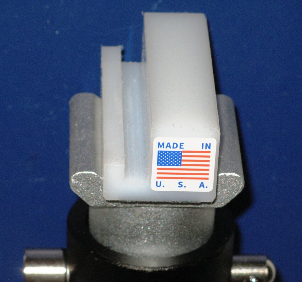

    I have experimented with many systems to lift cars for work and tire rotation.
    These included expensive Safe Jacks Rennstands, the Bend Pax Quick jack system, the newer VKRP budget jacking system similar to Rennstands and the Harbor Freight aluminum flat top racing jack.
    After nearly 15 years of experimentation and development and attempting to find the least expensive and easiest to use system, I have developed the current best option.
    Most all jacking systems failures are the result of the car falling off the top lifting point of the jack. Preventing this from happening prevents damage to the underbody of the car and more importantly, personal injury.
    Better than the larger awkward and heavier Harbor Freight 1.5 ton aluminum racing jack is the really inexpensive, compact and well made $42 Walmart 2 ton trolley jack weighing in at 18 pounds with an easy to carry top suitcase like handle.
    The top swivel cup is not ideal for lifting ant Toyota at or near the pinch weld. Used as is will damage the fabricated sheet metal.
    The key is a replacement adapter that locks onto the pinch weld without damaging it and keep the top of the jack firmly locked, while allowing the hack to roll to compensate for the changing geometry of the car as it is lifted.
    Similar adapters are available especially for aluminum jacks stands sold by Big Red, Harbor Freight and many other vendors.
    The cars rails inboard from the pinch welds are as strong as the pinch weld jacking points and can be used with the adapted jack for lifting to place the jack stands.
    The uploaded photos show how this system works.

    How would a static load at the official pinch weld jack points be any greater stress on the body than dynamic loading of the vehicle in motion?

    Who said it was aĺ right to lift one side of the car at the center point between her wheels?
    Service technicians routinely raise one side if a car at the prescribed pinch weld one corner at a time.
    No need for AI. Stupid suggestions like yours apparently predate AI.
