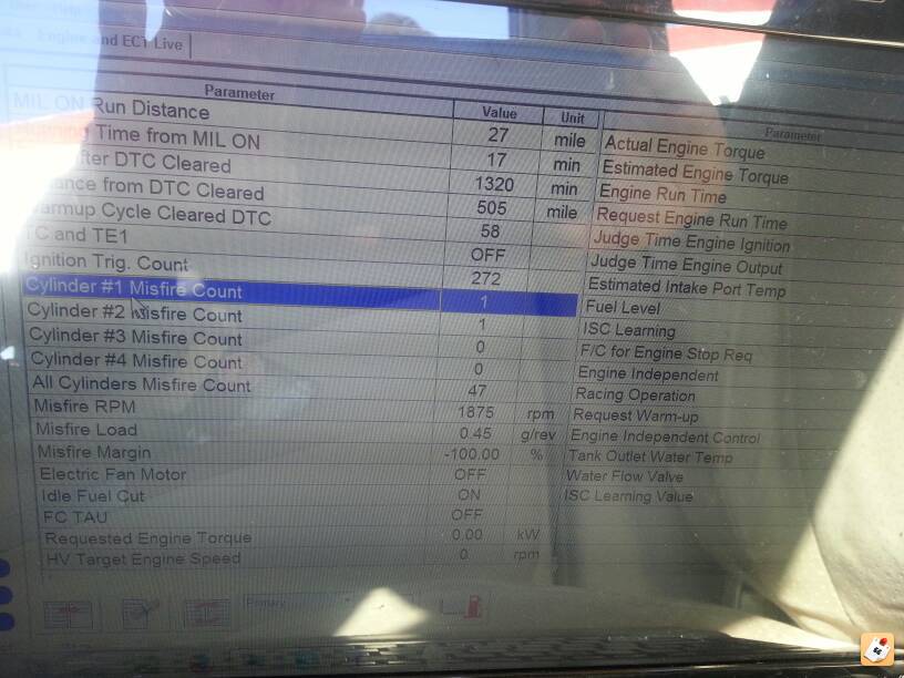

    It registered 300 series codes that indicates misfires.
    He's going to check plugs then go from there [​IMG]

    Done...
    Found oil in #1 cylinder. (cleaned that out).
    Inspected ignitor pack connector ends and seals.
    Installed new plugs.
    He mentioned possibly oil got into #1 cylinder because of close proximity to oil fill tube.
    I'll report back if this doesn't hold up and the misfire re-occurs.
