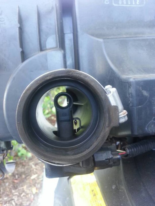

    I still have this nagging suspicion that your MAF may have gotten some kind of contaminant in it when your mechanic cleaned the throttle body.
    If the other things you're doing don't resolve the issue, check out Hobbit's thread about 100k maintenance, the part about the MAF.

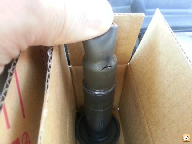

    Think I located the problem.

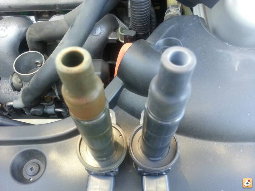

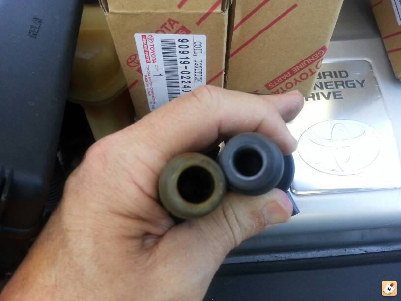

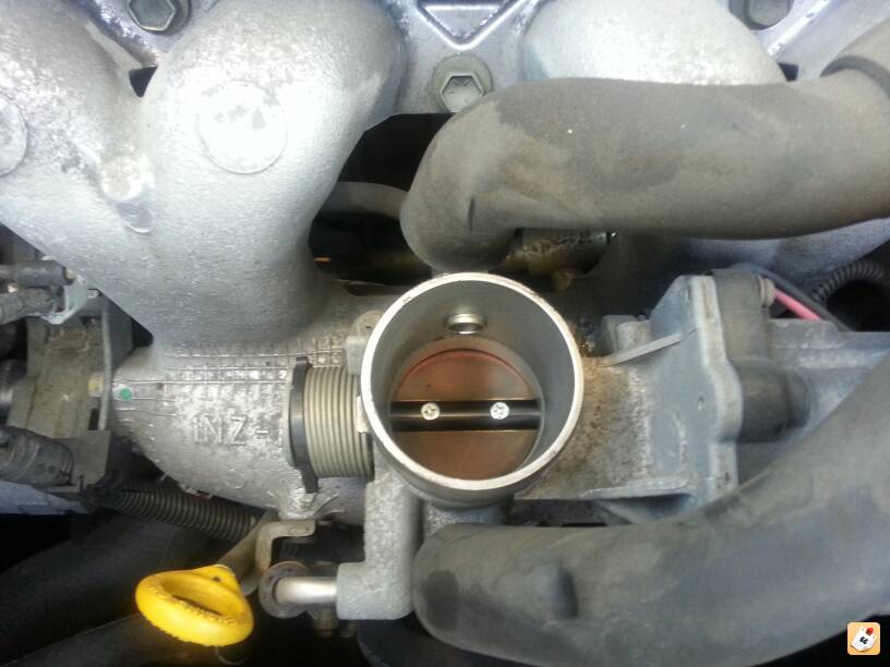

    couple more pictures just for grins....

    Good, was only one spark igniter defective?
    The throttle body interior looks very clean.

    Only the one showed obvious signs of defect.
    Happy this was such an easy fix and that I found such a good price on oem parts.

    Looks like you did have water on the coil.
    Toyota identifies this problem in a Technical Service Bulletin (TSB EG063-05) and
    recommends replacing any damaged plugs and coils and updating the seal on the cowl.
    You already did this.

    All 4 Patrick......
    And looking at the condition of the old one's I'm glad I did.
    One thing evident on all of the originals was the rubber boot that goes over the plugs ...all appeared loosely stretched and worn out. This can be seen in one of the side by side pictures I posted.

    Cracks in the ignitor are quite common here. Look at the ignitor boot up to the sun while bending it. Even a tiny hairline crack will leak hi voltage and misfire you.
    The spring on the throttle body looks bone dry and the butterfly is pretty rusted. Spray some lube on the that spring and rotate it before and after and see how easily it turns.
    Open up the butterfly by turning the spring and shove a rag down its throat all the way into the bottom of the mani. Soak the rag with choke cleaner and with gloves on scrub that butterfly top and underside with the now wet rag. Disconnect that big hose at the top of the TB and with stem on choke cleaner flush out that hose spigot as thats pcv in and gets very gunky. Look at the hose end carefully and see how gunky it is/ may need hose & pcv replacement also. Especially if the car lives on dyno oil.
    If either the spring gets so corroded or the edge of the butterfly becomes so rusted it begins to stick its new TB time to the tune of $1200-2000.

    And like the op's picture shows check the diameter of the hole of the boot. If the boot hole is distended it may not fit the plug snugly and hi voltage may leak out there to.
