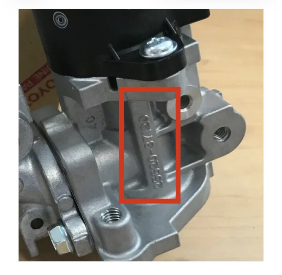

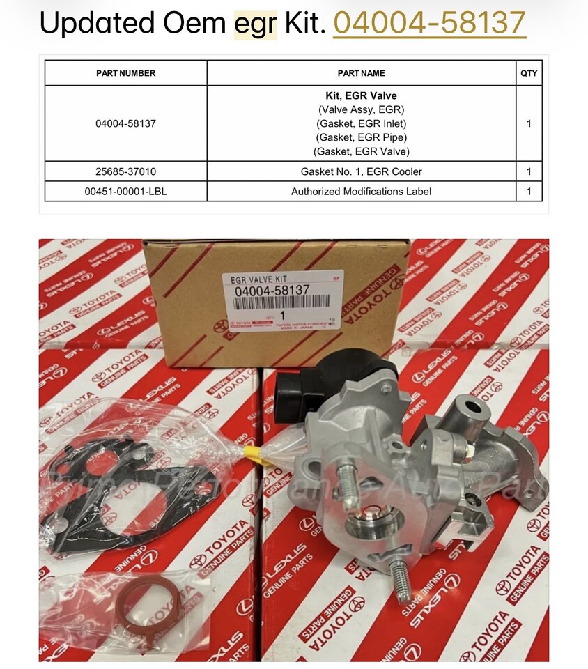

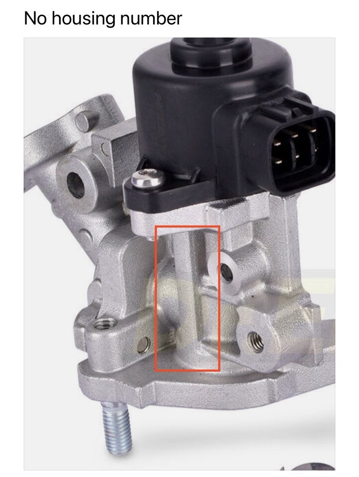

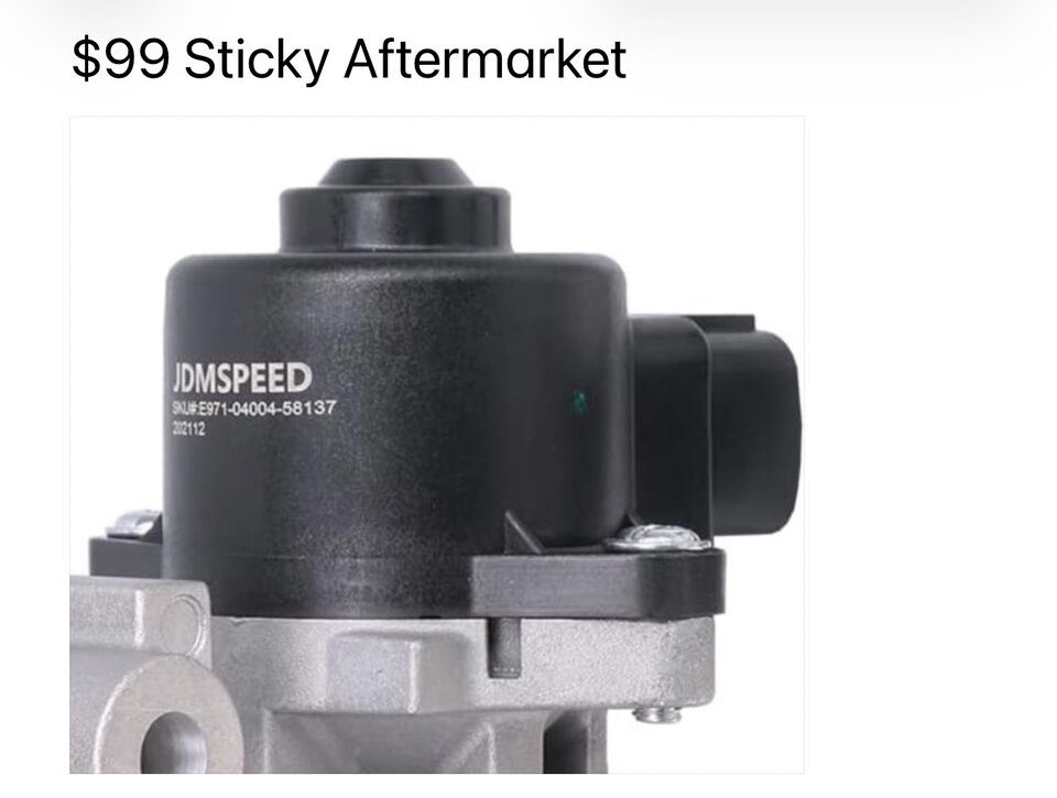

    It means your egr valve is sticking open. A clean can't fix it.
    Don't buy the low cost aftermarket valve. They have been known to stick right out of the box. You don't necessarily need a new intake.
    The egr kit is usually less money than the new valve by itself.
    04004-58137 - Toyota Parts Deal
    Valve itself
    25620-37120 - Toyota Parts Deal
    Top tips:
    Real dealers websites starts with autoparts.(dealername). or parts.(dealername)
    Prices vary dealer to dealer, sometimes by a lot.
    Search by part number; look for free shipping over $75; if the kit does not show up call or email them them.
    Amazon and others say its oem with part number, look for the housing number.
    If you are very lucky, a local dealer may have the part kit. Order online if price is good and ship to store is an option. Finally all discounts, especially national sales, don't show until checkout. You can go that far and don't buy if its not a deal.

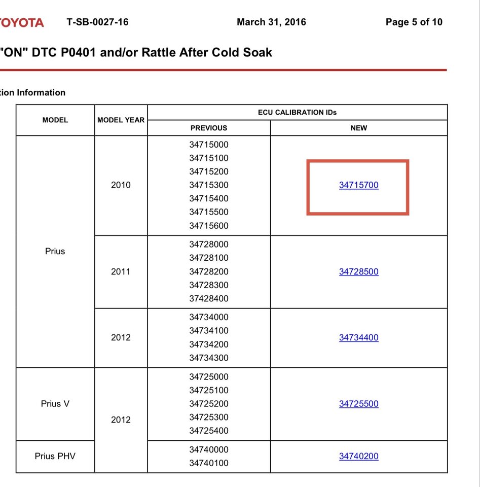

    Is the TSB refered to in the video T-SB-0027-16? I want to make sure I have the right computer software update for when I go talk to the dealer about getting it after I change the valve. If that's right, the software update looks like it's ECU part number, 89660-47306. Thanks!
  17. rjparker
    rjparker Tu Humilde Sirviente
    Jun 6, 2008
    11,126
    6,981
    Texas Hill Country

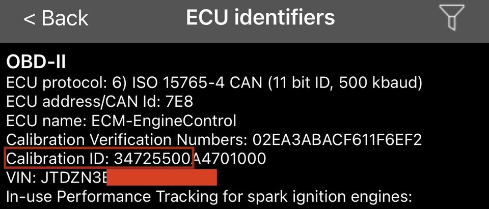

    You don't want the ecu - you want the latest "calibration id" (ecm software version) for your 2010 car which is
    34715700 or later.
    I would tell them you installed the new egr valve kit specified in the tsb and want the latest ecm update. When they run their online Techstream it will tell them the latest.
    This service might be worth shopping for if you have several dealers or a good independent with access. Most will charge a hours labor but it's probably 30 minutes of labor at most.
    The new egr valve will work fine without the latest ecm software but there are other improvements very likely included such as improved water pump controls.
    Which is why I had mine updated.
    Autel? Its good to have something that will read everything and hopefully the ecm calibration id before and after.
    Car Scanner on my 2012 v
