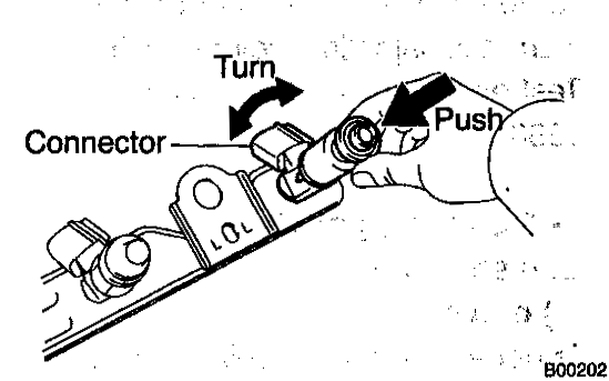

  14. ChapmanF
    28,654
    18,970
    I believe the O rings usually at risk of getting pinched are those between the injector and the fuel rail, so leaving the injectors in the head wouldn't eliminate the need to be careful reinserting the ends in the fuel rail. The bottom ends sit in the head in much more trouble-free grommets.
    The pinching can be an issue whether they're Toyota's or somebody else's O rings. More a matter of technique:
