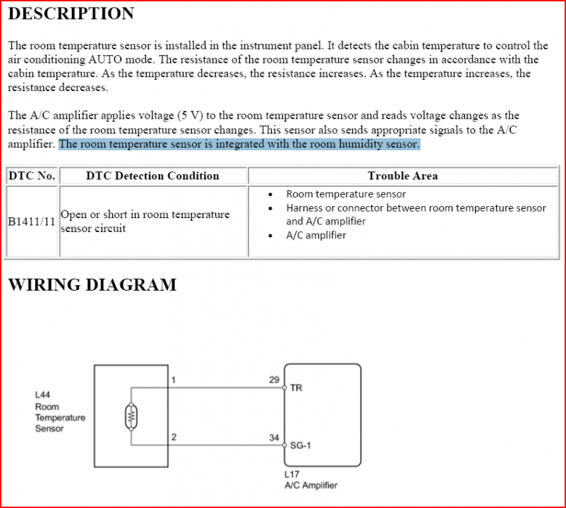

    According to the Repair Manual description of how the Climate Control system works there is a humidity sensor.

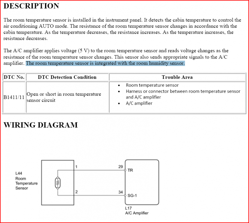

    The manual also shows the room temp / humidity sensor having a 2 wire analog connection back to the AC ECU. I do not see how this sensor can pass both temperature and humidity information to the ECU per the description and diagram below.

    Integrated with the temperature sensor would typically mean that its in the same housing. May have a single part number. Wiring to the temperature sensor and humidity seems be separate in this case. Once that was always the case but now they sometimes use active sensors that transmit digital data rather than passive analog devices.

    Read the last paragraph in the attached description again. It describes more than just an analog temperature signal. This sensor also sends appropriate signals to the AC amplifier.

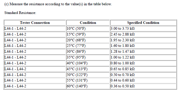

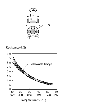

    There is no other mention of separate connections to the AC ECU. The following shows the temp sensor is merely an analog RTD sensor with a two pin interface, and even shows the range of expected resistance for troubleshooting. There is no other mention of the humidity sensor, in the manual.o_Oo_Oo_O

    Yea but the verbal description is inconsistent with the schematic and the sensor type. See another excerpt I included above.

    Here is more on the sensor:
