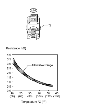

    I understand what you are saying and have read the Repair Manual searching for answers on the humidity sensor. Without the Toyota specs on the sensor and the AC amplifier, all we can go by is that one statement in the description.
    Addendum: I just searched the Repair Manual for humidity. On page 5889 under a Communication Table chart it shows a communication between the Power Management Control ECU and the A/C Amplifier that lists a "Compressor humidity control start flag".
