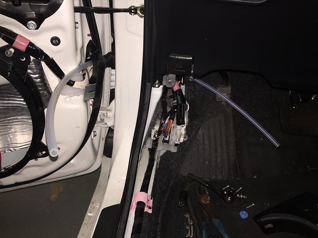

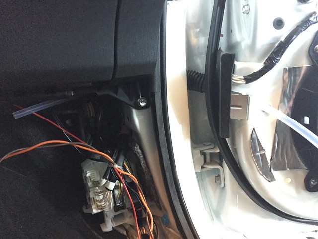

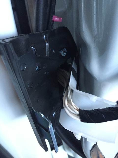

    I'm adding a few more details that should help anyone needing to do this. It was actually quite easy with a the tube trick I found.
    First remove door panel. Locate 2 bolts that hold wire harness boot on the door. Remove with 10mm socket. Open the boot assembly up by removing black tape or heat shrink from section where wires exit. Once trimmed off, unclip the plastic from the metal piece. Now it's opened up. Take tube and gently run it through boot and wall of the car. Now run wires through tube. You many need some wire lube.
