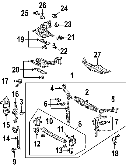

    Ok, I have searched and could not find a definitive answer.
    My question is this. Is it imperative that the upper splash shield be installed on the Prius at all times?
    I am trying to monitor the level in the radiator to see if there is a leak. I want to remove the splash shield and drive the Prius for an extended amount of time without the shield in place.
    Will this cause any sort of problem?
    Refer to item #27 in the picture below for more detail of the part I am asking about.

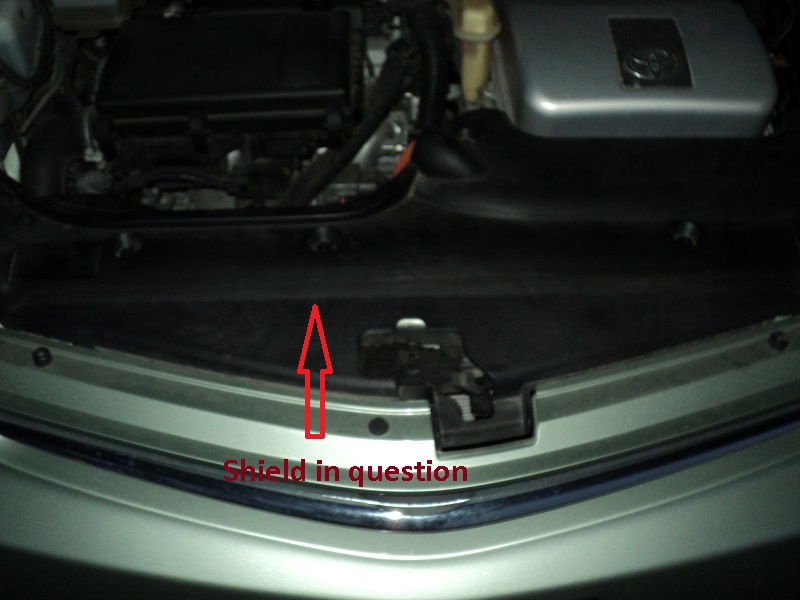

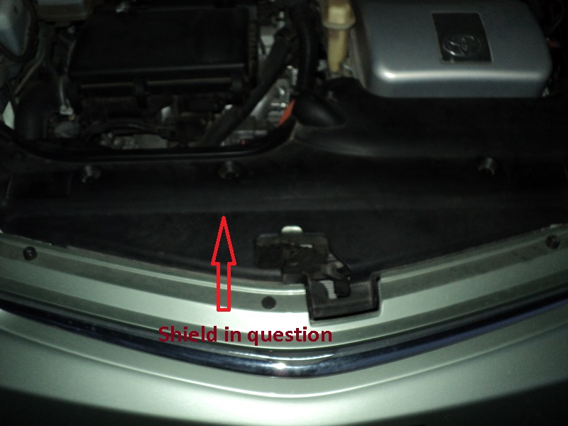

    The shield I am referring is on a Gen II Prius. It is on top of the radiator. It is held in place with seven fasteners. It covers the radiator cap making removal of the shield imperative if one wants to check the level of the fluid in the radiator. Relying on visual check of the overflow bottle is not sufficient in all cases. It is best to check the level of the radiator itself by removing the cap when the system is cold.

    You have at least two choices:
    (1) You can run the car without the shield until the coolant level stabilizes.
    (2) You can put the shield in but leave the fasteners out. You can then pick up the shield to check the radiator level. You could always install one or two fasteners if you were worried about it flopping around or if it rattled.
    I did both for about a week after replacing my radiator fans without any problems. I checked the radiator level every day to make sure the radiator was full.
    I believe the main purpose of the shield is to improve the flow of air air through the radiator. I doubt it will make much difference unless the outside air temperature is high or you are using a lot of air conditioning. This time of year should not be a problem in the US.
