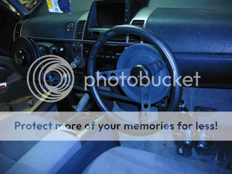

    a quick FYI, we are converting our 08 prius to RHD tomorrow. I will take pics and keep u updated on it. Very excited/nervous at the moment!
  16. dixiemailcarrier
    dixiemailcarrier Junior Member
    Mar 8, 2009
    AL
    after a day of snow, sleet, ice and frigid cold.... prius is converted to RHD. pics soon to follow!
  17. dixiemailcarrier
    Mar 8, 2009
    AL
    pics of 08 prius rhd conversion by postalthings.com. They do not move the emergency brake so hubby mod'ed that into the equation. Overall, a 5 star experience.
