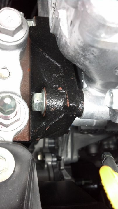

    Hi guys,
    So I was checking my oil the other day and something caught my eye... It looks like some rust is developing to the left of the engine. Is this normal? I've only had my Prius for less than six months.
    Thanks!

    No worries. Take a look at some suspension components, or the disk brakes: they do rust.

    Very normal and it gets worse depending on where you live during this winter.
    Salt was used so much I can only imagine what new rust will appear this year.

    Sure thing, I'll check everything on the next oil change at 5K. I'm just surprised to see rust in the engine block when the car is still so new. :( Plus, it's not like the engine is exposed to water, unlike brakes or suspension, and I live 200+ miles away from the nearest coast, so sea salt in the air shouldn't be a factor, either.

    rrg, thanks for the reply. I live in the Southeast, and there had been no salt on the roads as far as I remember. The couple times the roads iced over this winter the whole place was just shut down until everything thawed out. I'm just puzzled to see rust forming so soon in a place where I wouldn't expect it to form yet.

    Quite normal. There was another thread on this several months back.
    Mine also had some rust on it when it was only 2 weeks old. I did spray a bit of rust inhibitor oil on it but that's only visual since it only covers the part I can see. I know there are other parts that I can't see that are likely looking rusty.

    That is a massive nodular cast iron mounting bracket. It will last for many many years longer than the car, itself.
    So, there is no need at all to worry.
    If you don't like the look, brush off the rust and treat it with rust converter. The, brush some black paint onto the part.
    The touch up would be for your peace of mind and cosmetic purposes only.

    If that upsets you wait till you see the suspension.
    Apply this product:
    Blaster Corrosion Stop Protectant - PB Blaster
    Found at Home Depot. Its an excellent product a spray grease that stays where you put it and does not smell.
    Spray it everywhere that needs lubrication. Hinges-locks-bolt heads. Spray it on those rusts spots you linked and they will stop rusting.
    Spray the entire suspension underneath especially the lower control arm bushings. Don't go crazy just a little bit.
    Nothing on my car is rusted and no squeaks or rattles. And underneath looks brand new.
    While your going to town under the car apply rubber conditioner to the cvt joint boots. They will last a long long time if you don't let them dry out. I like Black magic Protectant.
    Its a machine. It needs lubrication.

    Rust? You're concerned by that? Boy I've seen it all now.
    That is absolutely and perfectly normal. If the entire item was covered in it and bubbling then you have a problem. What you have is know in the trade as 'nothing'. ;)

    I just noticed this rust in the exact same area in my Prius.
    I don't think it is functionally any reason for concern.
    It just seems to appear quickly and is so visible when you pop the hood that it can be "shocking" to suddenly look down and see "rust" where none seemed to be just weeks earlier.
    Since it is so visible, when I get around to it, I might clean it off and use some inhibitor...just so it looks better.

    Yeah, I really wouldn't worry about it. You will be rid of the car long before it falls apart due to rust in like 40 years or whatever.

    Heavy, forged suspension components are not stainless, and the manufacturer knows it's going to rust, it in no way compromises it's strength. It's not a readily visible, cosmetic part. It would be a fools mission to even try to remedy it, would end up looking worse. Have a look under the car, and you'll see lots more. Or the suspension components in the wheel wells, disc brakes, and on and on.

    Some parts are made with steel that is meant to form a small layer of rust. It will only form a surface rust with no loss of integrity. If you look at a lot of bridges and big transmission towers they haven't been painted and rusted over, but the rust stops and thats by design. Not to worry.
