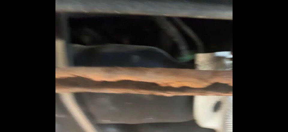

    Dangit .... rust has taken out my passenger side brake cable, and now my rear cross brace, and my car is only 9 years old. I believe it's part number 53605-47021. Over $200 for a simple steel tube. Fortunately my rusted out passenger side parking brake passed the year inspection since the driver side still holds strong, but this piece failed me instead.

    Second such we’ve seen here. Odd failure. Lots of road salt and anti-icing chemical exposure?

    I live in upstate NY and bought car used from Vermont, so yes lots of road salt. I tried to car wash after snow, but looks like it didnt help in the end. My experience is Toyota has bad at rust protection in my time up here.
    Is there a thread for the other failure? I want to make sure I get the right part.

    I found the thread. I blasted the bolts with penetrating oil and then tested them after dinner. All 4 bolts broke loose real easy, so I'll just need the overpriced bar and looks like it should take only 15 minutes.
    I believe I need 53605-47021, correct?

    Description: BRACE SUB-ASSY, REAR SUSPENSION. Part Number: 53605-47021. Usage: ZVW41

    Thanks. I may preemptively get fuel tank straps too. The bolt end on the right strap looked very rusted. I'll look again today before I order parts, but definitely don't want a fuel tank strap to snap for me or future owner.

    The rear jacking point looks pretty bad too. Hard to judge from pic, but be careful with it.

    It is pretty bad actually. I looked that part up but it's not worth replacing. It'll be cheaper to get pinch weld adapters for the floor jack.

    Got my new brace. Felt very light so I used my micrometer to measure the thickness. Appears to be about 16 gauge metal. Thin enough that I could fold it in half by hand if desired ... definitely not designed for compressive forces lol.
    And some better pictures of the original thay literally was barely holding together.

    Astounding fail from Toyota. They need to apply a little more of their “continuous improvement” to the underbody/suspension rust resistance.

    It's essentially a thin piece of sheet metal (I had measured it, and if I remember right, it was about 16 gauge steel), so once it starts to rust, it doesn't take much to rust through since it's right there exposed to all the road salt we get here in the northeast. I know in NY, as long as there are no rust holes, it passes. But just because there's no holes yet doesn't mean it's not structurally gone and I can stick my finger right through it.
    My guess is yours was either overlooked the past 2 years, or it was essentially rusted through, but holding on just enough that whole pieces hadn't fallen off yet. Fortunately it's a real easy part to replace with just 4 bolts holding it on, just way way overpriced for what it is.
